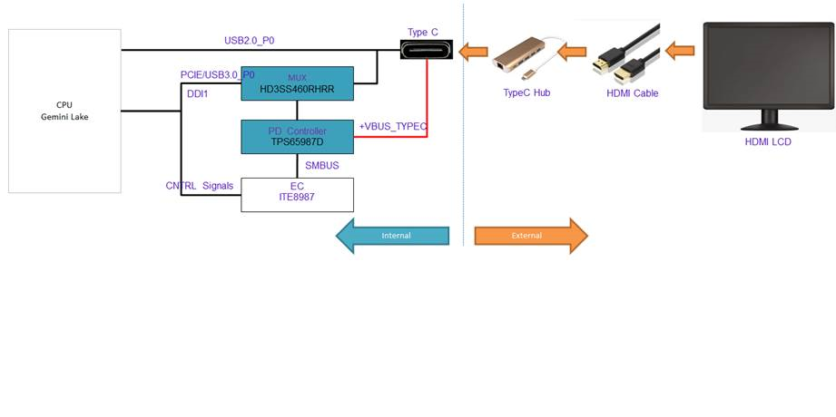

Hello

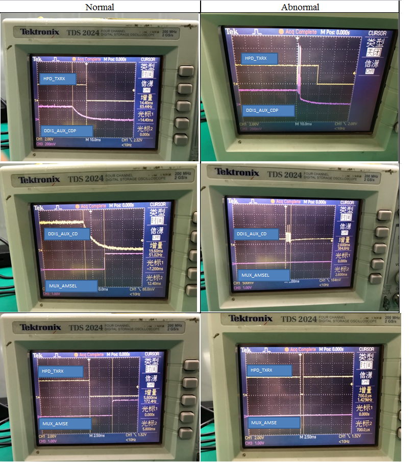

Customer use Gemini Lake and use HDMI dongle via type C connector to connect to Monitor with HDMI. If drop down type C cable for hot-plug, The display will show black screen. But if initial Gemini Lake from sleep mode to active mode. the display recovery and work normal.
Has any solution to solve this issue? Customer use TPS65987D and HD3SS460 on their board. Thank you.
BR
Patrick
