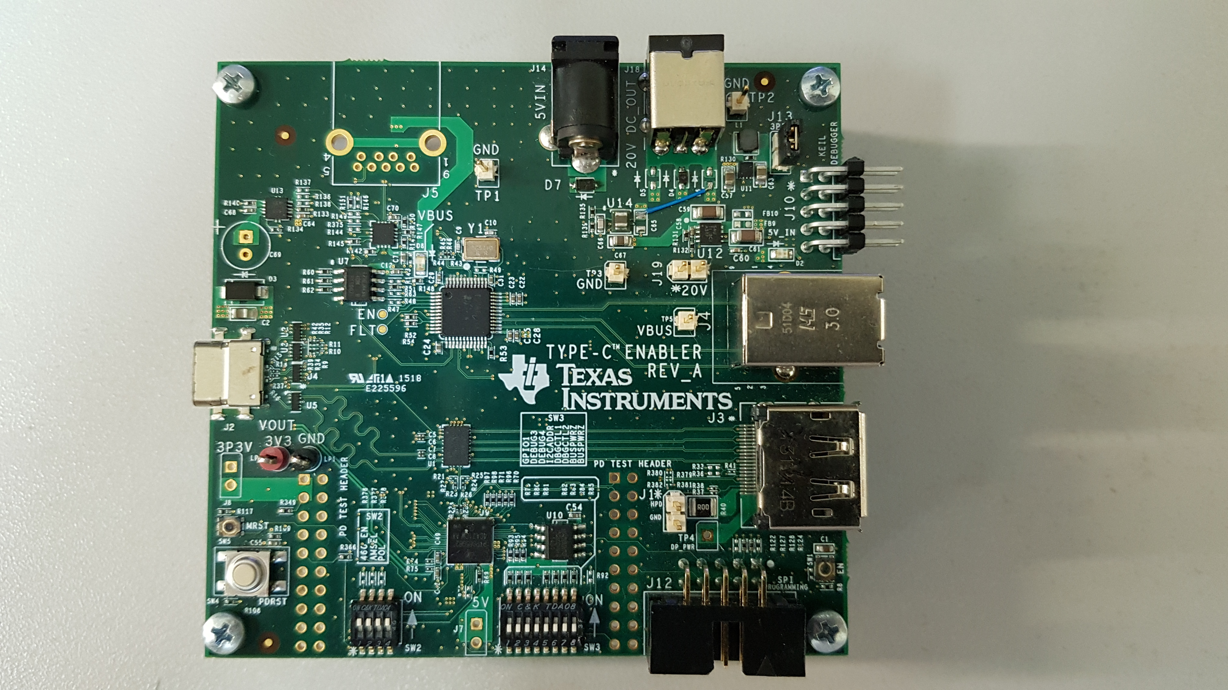

I have TypeC Enabler (rev A) board connected to a monitor from TypeC side and to a laptop from DP side. This work well after power-up. But after Type-C cable replug, TPS65982 failed to detect cable connection. Switching to DRP role and back recover controller until next cable re-plug. As I see, in this state TPS65982 is in power sink role for strange reason and it does not pull CC lines up.
Could you help me to resolve the issue?
Project file and registers dump are attached.
