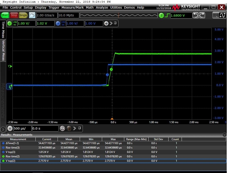

DS90UB913A-Q1: VDDIO need power up earlier than VDD, i am not quite understand what risk will be caused if we not follow the rules?
Part Number: DS90UB913A-Q1
hi team,
our datasheet says the VDDIO need power up earlier than VDD, i am not quite understand what risk will be caused if we not follow the rules?
Thanks.

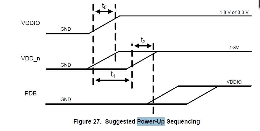

    Please refer to Figure 28 in the latest 913A datasheet on the web (Rev E) for the power-up sequencing requirements (the updated diagram includes the GPO2 state during power-up). VDDIO and VDD_n can be brought up together, this is ok as long as VDD_n does not ramp up before VDDIO (time t1>=0 in Table 8).
    If the power-up sequence is not followed the device operation and functionality cannot be guaranteed.
