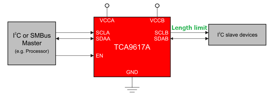

Hi Team,
Customer wants to know this device output length limit, a rough number is also fine, thanks.
Andrew
  • Hey Andrew,
    The answer for this depends on if you are working at fast mode plus (1 MHz) or fast mode (400 kHz). The max capacitance allowed for fast mode plus is 550pF while fast mode allows 400pF.
    You can use the Saturn PCB tool to estimate trace capacitance here:
    From the image above, a 5mil width and a 10 mill height with a copper weight of 1 oz and plating thickness of 1oz gives us about 1.7pF per inch.
    fast mode = 400pF/1.7pF/inch = 235 inches
    fast mode plus = 550pF/1.7pF/inch = 323 inches
    If I changed the width to 14mils then parasitic capacitance then goes to 2.73pF/inch
    fast mode = 400pF/2.73pF/inch = 146 inches
    fast mode plus = 550pF/1.7pF/inch = 201 inches
    You can play around with this yourself if you download the tool.
    -Bobby
