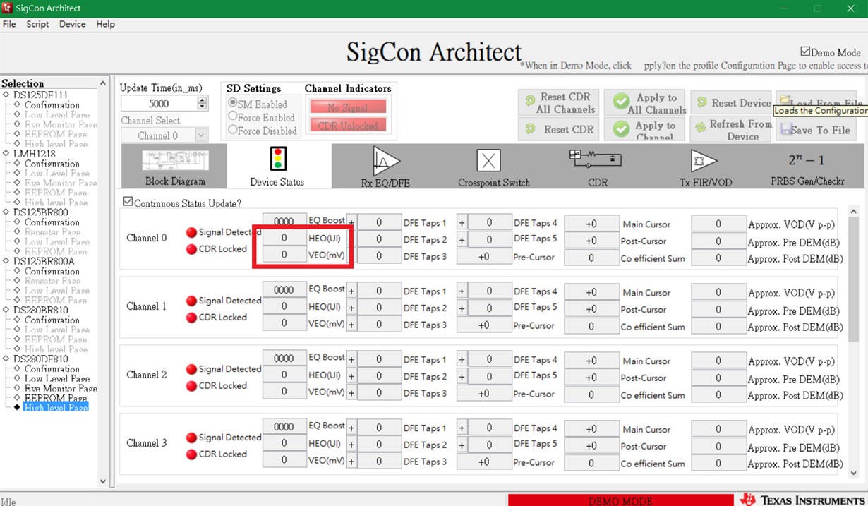

Can I use the DS250DF810 to confirm the signal quality at the input(Rx side)?

Yes you can use HEO/VEO measurement to check input signal quality. Please refer to the DS250DF810 programming guide for details.
