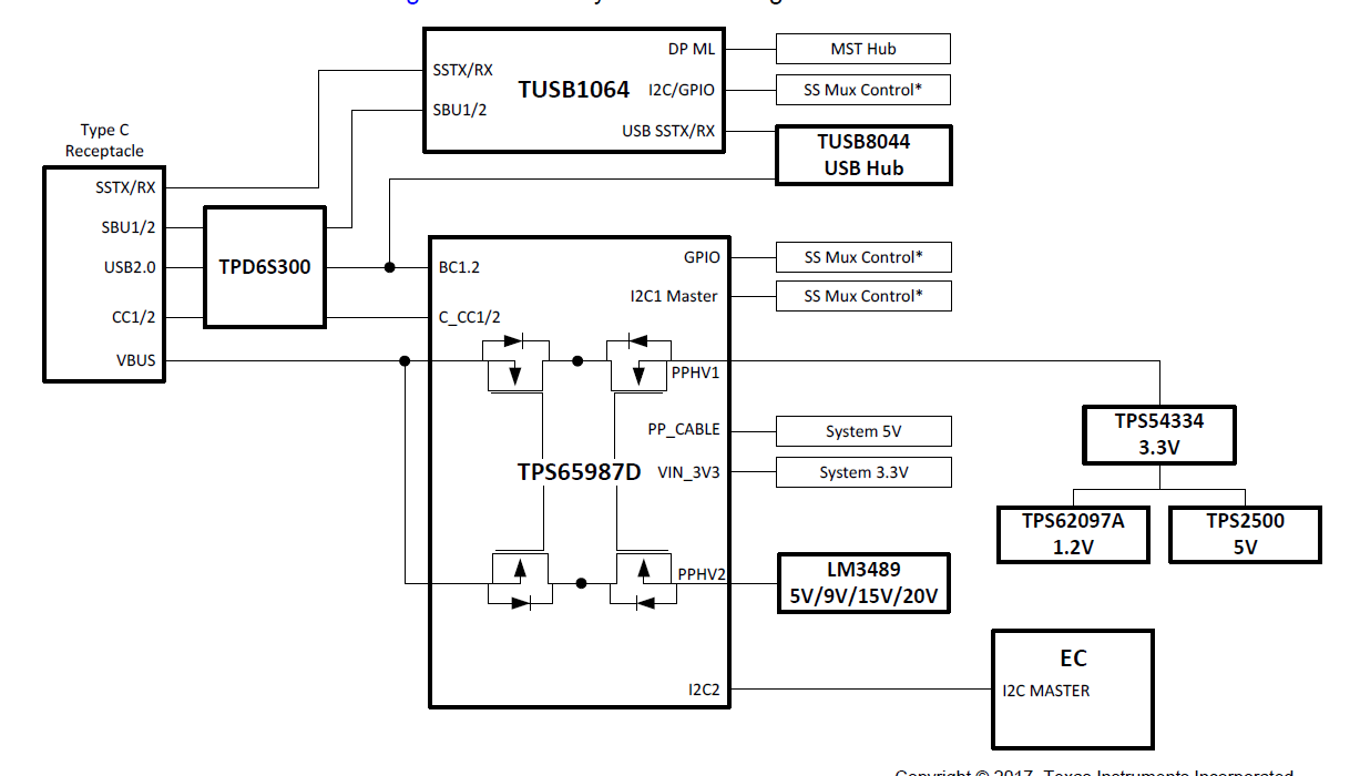

    In this scheme, our system does not have CE system control, and whether CC TPS65982 can also run directly, and control other devices as the master.     Or recommend a PD chip that does not require a CE system and can control peripheral DCs.
