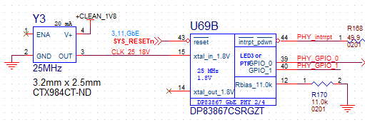

    The clocking source for the DP83867 in our design is done like this:
    This is exactly the same as we did for the previous (Marvel) PHY.
    The CTX984CT-ND (625M3I025M00000) is quoted to have a frequency stability of ±50ppm.
    Does the above look acceptable to you?
    Thank you for your time and help.
  • Hi Eryk,
    For some reason the image did not come through. Can you add the image as an attachment?
  • Hello Rob,
    Sure thing. Should be attached.
    I can see it still inserts it as an inline figure, so just in case I am attaching it also as a ZIP file.
    Thank you.
    DP83867ClockSource.zip
  • Hi Eryk,
    Thank you. I don't see an issue with your reference clock circuit. I believe any impact you might be seeing on signal integrity will be related to the shorted center taps for the magnetics.
  • Hello Rob,
    Thank you for looking it over and for your feedback.
    In future revisions/designs we will make sure to use the seperatelly tapped magnetics with this PHY, but for now we are glad to hear that we can keep using the current magnetics with no worry of causing damage to the PHY.
