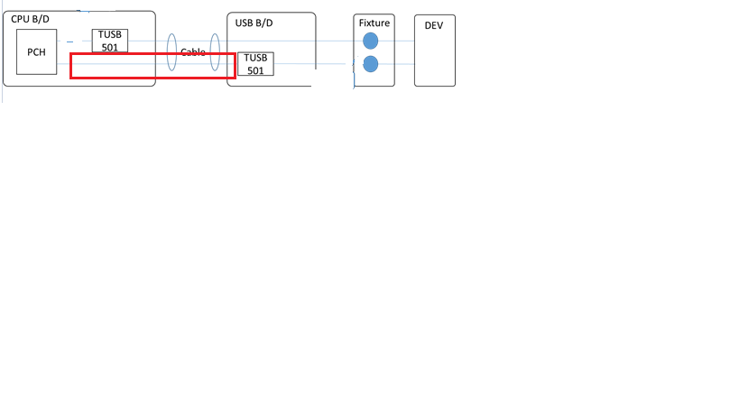

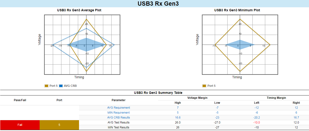

We are test fail on intel IEMT port5

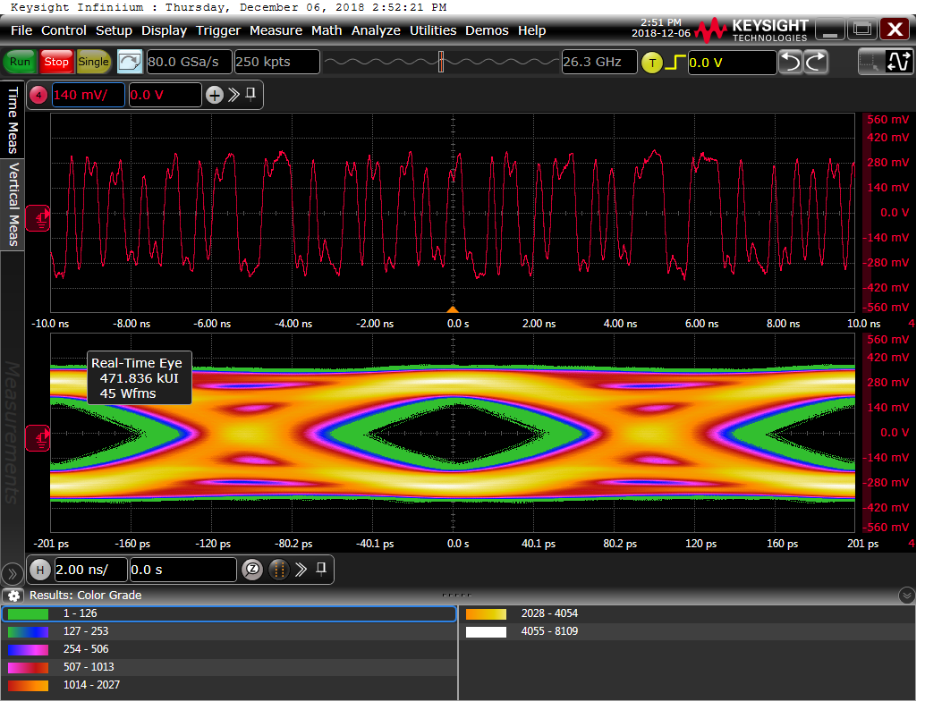

The USB3.0 RX SI report as below (EQ=L DE=F OS:H is the best setting for us)
EQ:F/ DE: F/ OS: H
EQ:F/ DE: H/ OS: H
EQ:L/ DE: F/ OS: H
Looks waveform are OK but when we run IEMT tool will be fail.
So, could you share experience for us how to fix it?
