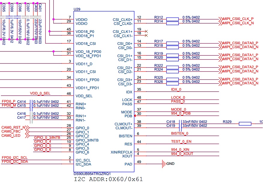

Our circuit as follows:

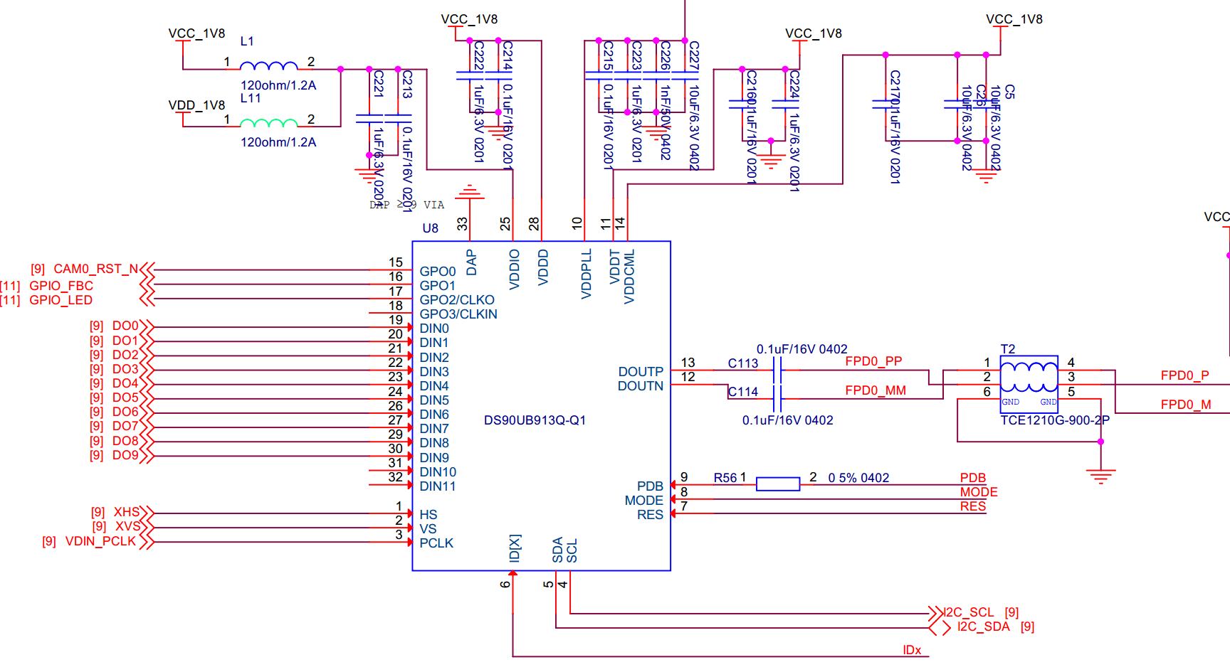

IMX291 ---> DS90UB913 ---> DS90UB954 ---> Qualcomm CPU

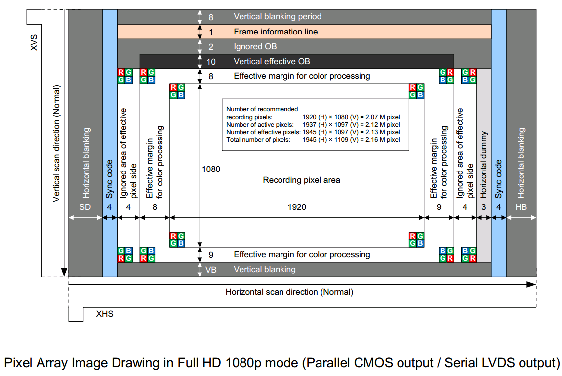

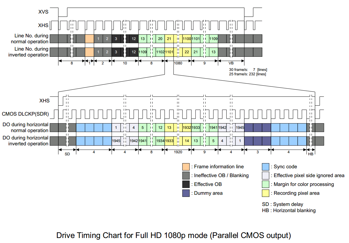

IMX291:Parallel CMOS output, 10bit, 1945x1097, Full HD 1080p, 30fps, 74.25Mpixel/s

However the CPU linux kernel log show as follows:
[ 69.514155] ispif_process_irq: PIX0 frame id: 0
[ 69.547509] ispif_process_irq: PIX0 frame id: 1
[ 69.580837] ispif_process_irq: PIX0 frame id: 2
[ 69.580894] msm_isp_process_overflow_irq: vfe 1 overflowmask 10,bus_error 3f9f
[ 69.584186] msm_vfe47_axi_halt: VFE1 halt for recovery, blocking 0
[ 69.591502] overflow processed
[ 69.629538] msm_isp_axi_halt: VFE1 Bus overflow detected: start recovery!
[ 69.647575] msm_vfe47_axi_halt: VFE1 halt for recovery, blocking 1
[ 69.714162] ispif_process_irq: PIX0 frame id: 3
[ 69.747542] ispif_process_irq: PIX0 frame id: 4
[ 69.747636] msm_isp_process_overflow_irq: vfe 1 overflowmask 10,bus_error 3f9f
[ 69.750957] msm_vfe47_axi_halt: VFE1 halt for recovery, blocking 0
[ 69.758259] overflow processed
[ 72.052223] msm_private_ioctl:Notifying subdevs about potential sof freeze
[ 72.052397] msm_csiphy_irq CSIPHY0_IRQ_STATUS_ADDR0 = 0x0
[ 72.058063] msm_csiphy_irq CSIPHY0_IRQ_STATUS_ADDR1 = 0x1
[ 72.063528] msm_csiphy_irq CSIPHY0_IRQ_STATUS_ADDR2 = 0x0
[ 72.068912] msm_csiphy_irq CSIPHY0_IRQ_STATUS_ADDR3 = 0x20
[ 72.074288] msm_csiphy_irq CSIPHY0_IRQ_STATUS_ADDR4 = 0x0
[ 72.079667] msm_csiphy_irq CSIPHY0_IRQ_STATUS_ADDR5 = 0x0
[ 72.080922] ispif_process_irq: PIX0 frame id: 74
[ 72.090512] msm_csiphy_irq CSIPHY0_IRQ_STATUS_ADDR6 = 0x4
[ 72.095207] msm_csiphy_irq CSIPHY0_IRQ_STATUS_ADDR7 = 0x0
[ 72.100500] msm_csiphy_irq CSIPHY0_IRQ_STATUS_ADDR8 = 0x80
[ 72.105885] msm_csiphy_irq CSIPHY0_IRQ_STATUS_ADDR9 = 0x40
[ 72.111752] msm_csid_irq CSID0_IRQ_STATUS_ADDR = 0xff
we find DS90UB954 get image size (reg 0x73-0x76) is WRONG!!!!
Can you help me to slove this problem?

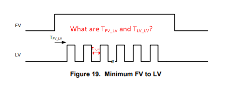

  • Hello Stephen,
    Are you using the 913 or the 913A?
    There are some timing requirements when operating the 954 in DVP mode.
    Based on your registers settings, the FV_MIN_TIME is set to the default value of 128. When operating in RAW10 mode, this means that there must be a delay of 261 PCLK cycles between the initial FV and the initial LV (in your case, this would be 3.52 us). Can you check that this is the case?
    Also, can you share what the inactive period is in between each LV signal?
    Please try running the internal pattern generator on the 913 and see if you also have errors in that case. This will help rule out other configuration issues.
    Zoe

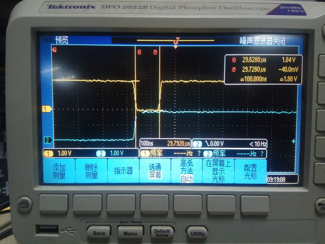

    I can't understand " the inactive period is in between each LV signal",  so I paste the snap picture from the IMX291 specification.

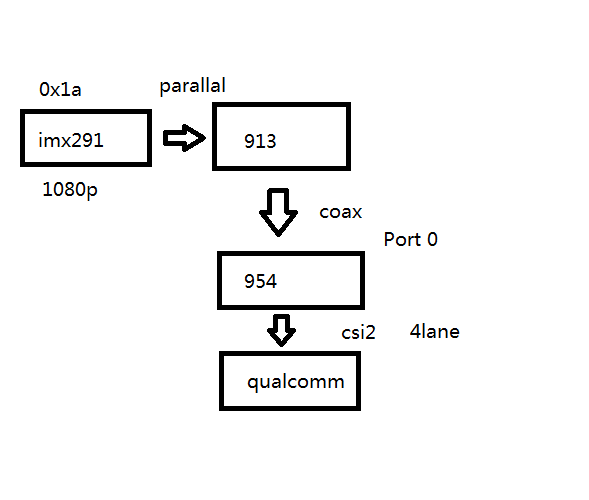

  • Hi Stephen,
    Can you share a block diagram of the system with me? Registers 0x73-0x76 are only accurate for a single video stream; are you using both input ports on the 954?
    Can you please measure at the input to the 913 what the time is between the frame valid and line valid and in between assertions of line valid? See the diagram below.
    Zoe
  • Hi  Zoe,
    Our system diagram is shown as follows.
    We can't find the FV, LV in our circuit. So we measure the XVS, XHS, you can find them in 913, then we get Tfv_lv is 29us, Tlv_lv is 30us.
  • Hi Stephen,
    Thanks for sharing the block diagram. One note, It is recommended to use the DS90UB913A-Q1, not the 913 for coax applications.
    That timing should be ok. Can you also measure this timing at the 954 to confirm? FV and LV can be output on the 954 GPIOs for measurement. Please share the picture of the waveforms.
    As well, are you able to view the image on a display? If possible, can you display the image from the output of the deserializer and also display the image directly from the imager?
    Can you also confirm that the devices are consistently locked (that lock is not intermittent)? I noticed that register 0x4D on the 954 has the lock_sts_chg bit checked.
    Zoe

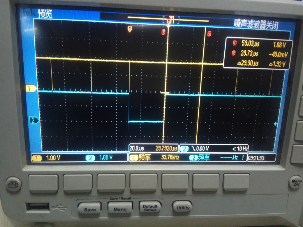

  • Hi Zoe,

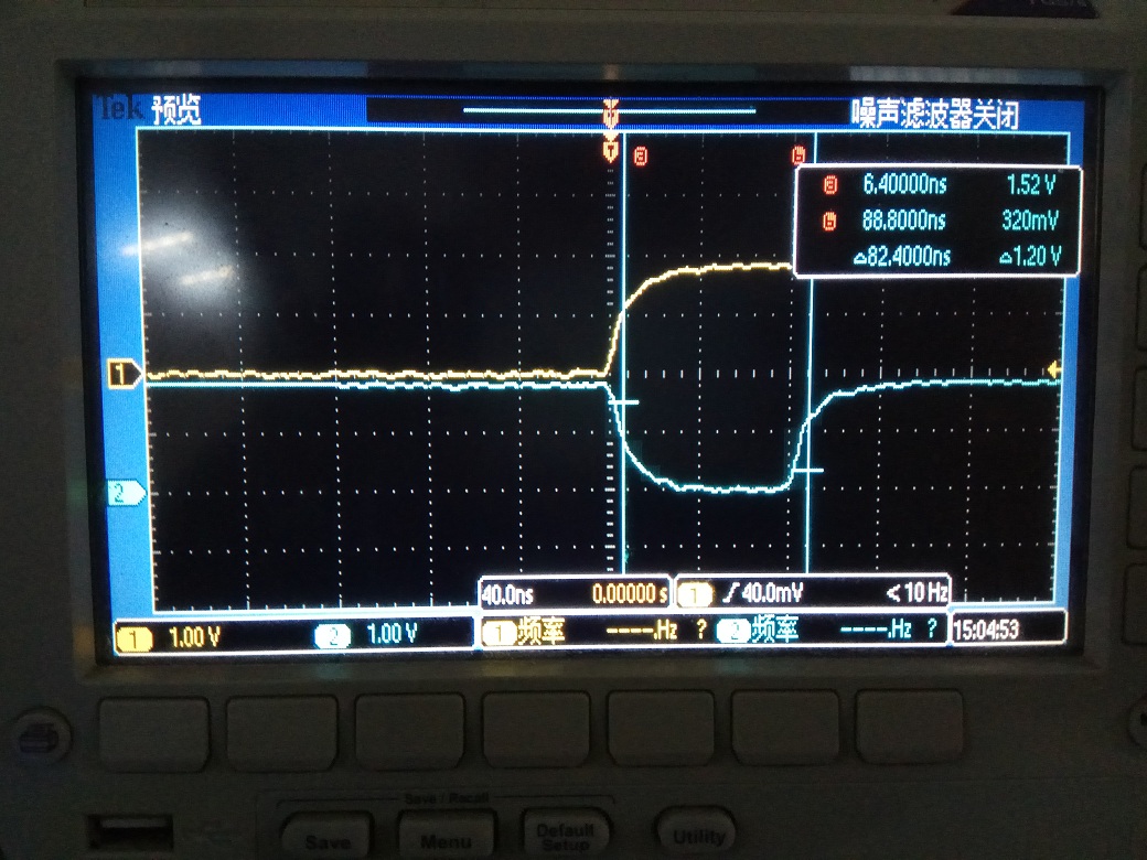

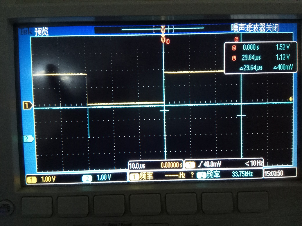

    Thanks for your suggestion. I have found the 913 chip on the circuit board. We actually use DS90UB913A-Q1.
    I measure the 913 XHS,XVS again.  Tfv_lv is 100ns, Tlv_lv on 954 gpio is 29.30us.
    I have measure the FV and LV on the 954 GPIOs. Tfv_lv is 82ns, Tlv_lv on 954 gpio is 29.64us.
    I have tried to get the image from qualcomm CPU, but all fail. Sorry.
    Before starting the sensor to capture, I read 0x4D to clear the lock status change bit. Then I start the camera, the lock_sts_chg bit always 0.
    Stephen

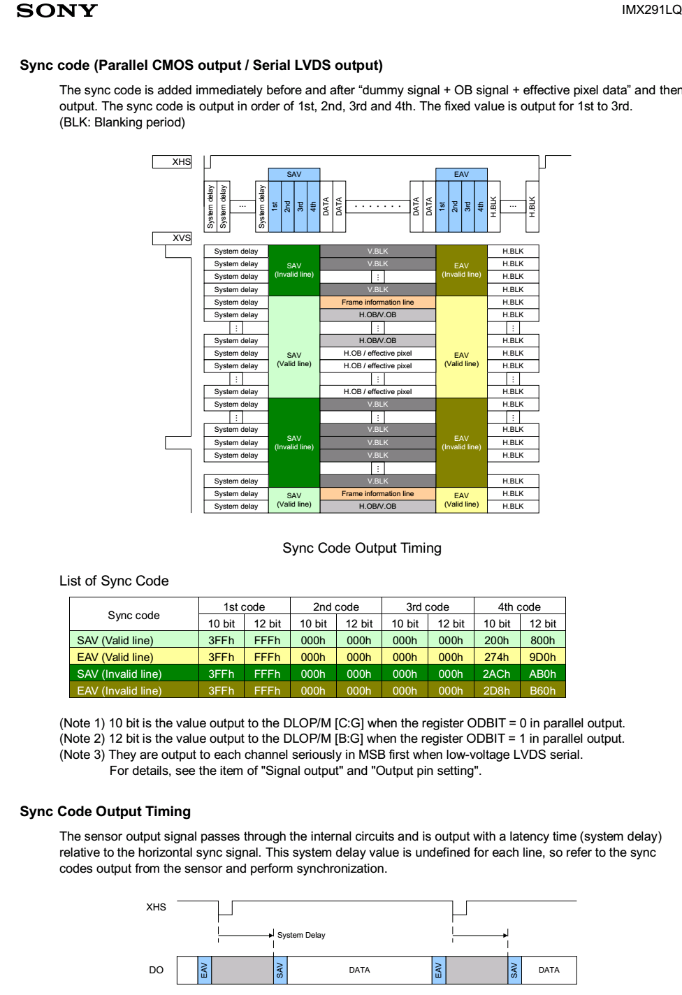

  • Hi Stephen,
    I assume you are using FV_MIN_TIME of 0x0. As long as your FV_MIN_TIME is 0x02 or less, this timing should be fine.
    Can you double check your imager configuration?
    Zoe
  • Hi Zoe,
    We use 913 and 914 previously, the imager is imx291. Now we only replace 914 with 954, and others are not changed.
    We use the same configuration. After checking the configuration, I think the imager's configuration should be ok.
    Stephen

  • Hi Mostafa,
    I have checked that the system was running in STP mode,
    When we use 953 with 954, they work ok. If we just replace 953 with 913, the 954 will be operated in the DVP mode .Which different hardware port of 954 should be configured in both cases? Could you give me some advice about this problem?
  • Hi Stephen,
    Can you please provide register dump of the following configurations:
    • 953 to 954
    • 913 to 954
    Since you indicated that everything works when you have a 953/954 connection and then the system fails when the 953 is replaced with a 913, it would be good to look at what is inside the registers.
    If I understand correctly, you did the following:
    1. Configure the 953 to work with the 954
    2. Verified the sensor and SoC were configured properly, and observed proper video frame output/size.
    3. Replace the 953 with a 913A (without modifying the sensor and SoC), and configure the 954 to backwards compatibility mode.
    4. Observe incorrect video frame output/size.

  • Hi Stephen,
    Can you please confirm that your PCLK frequency is stable/not changing? Can you measure what the PCLK is on the 913A input side and the 954 output.
