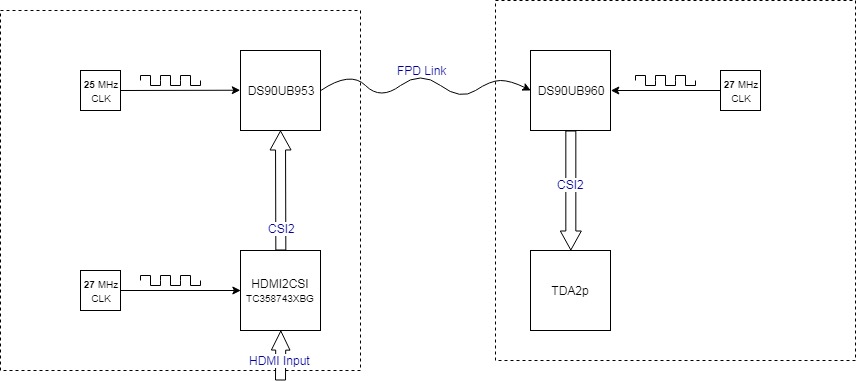

We have following setup:
HDMI input is 1920x1080, 60 fps and this video is converted to RGB888, 1920x1080, 60 fps, 4 lane CSI2 output. This video is sent to TDA2p chip via coax cable, but part of the image has noise, like on image below:
Can you help us to solve this problem? On receive side (TDA2p) CRC error is detected? UB953 is configured in non-synchronous mode with external clock. UB953 has 25 MHz external clock, but two other chips in the chain have 27 MHz input. Could this produce this kind of problems? Any other suggestions?

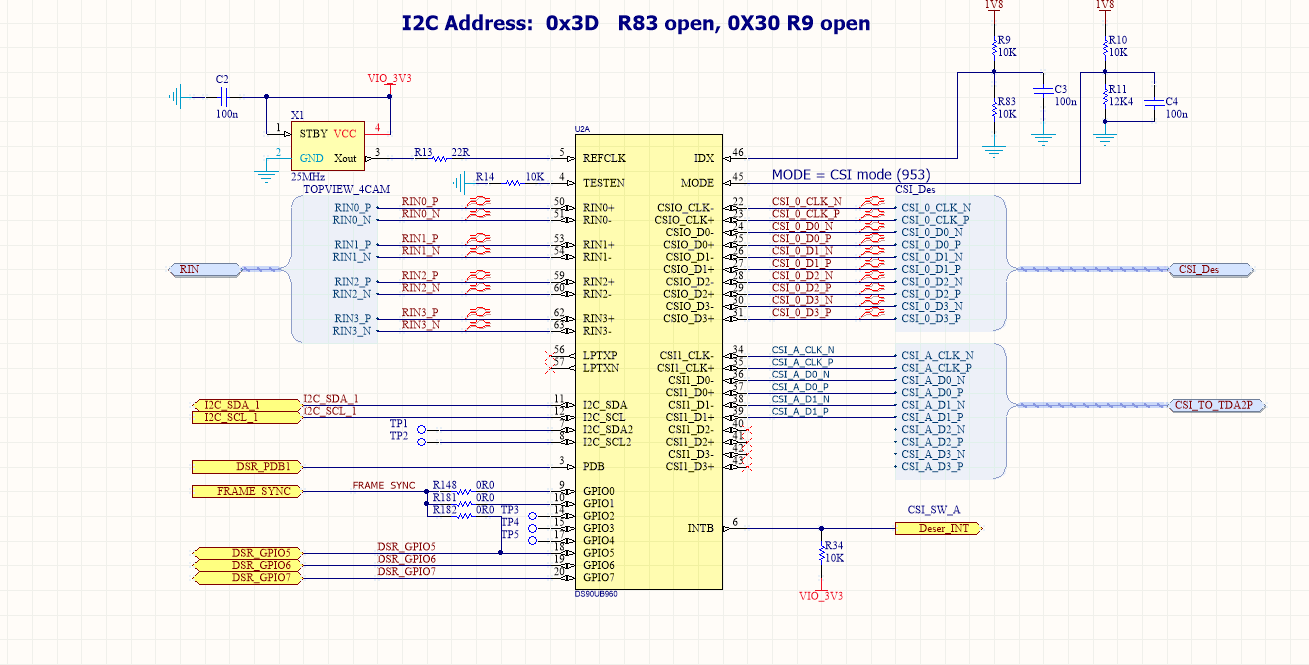

    You can download schematics for serializer here:
    This is schematic of deserializer:

    This issues is resolved. We had 25 MHz external oscillator and because of that FPD link rate was 2 Gbps.
    I switched to Internal AON Clock (50 MHz) - 4 Gbps line rate mode. We will put external 50 MHz oscillator in new HW revision.
