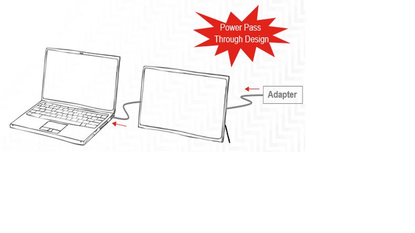

Hello
               Customer would like implement below topology via TPS65987D. Has no problem to implement this function for it?  What register of TPS65987 we can control to PD SInk/Source side to meet below function? Thank you.
1  NB supply power to Monitor.
2  Monitor supply power to NB while Adapter plug in.
3  NB supply power to Monitor while Adapter drop.
BR
Patrick
  • Hi Patrick,
    From your explanation it seems like you need a DRP port in the notebook port. You don't need to change any registers dynamically for this, just configure the PD controller as DRP.
