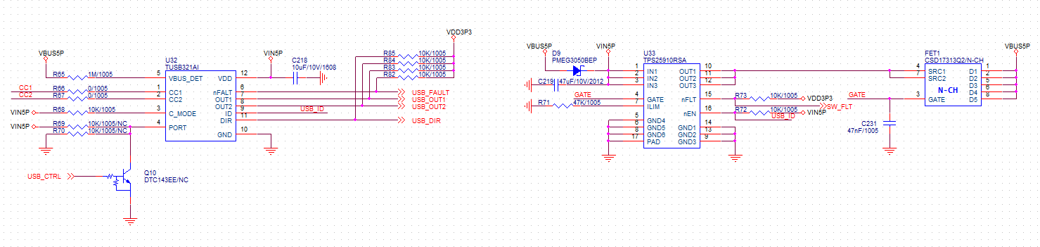

Can someone review the schematic?
I used the TUSB321AI and set it to DRP mode. (3A)
I tried to charge my smartphone, but it only outputs less than 300mA.
When the circuit is verified, I try to review the artwork.
Thank you.

Thank you for your reply.
Do you mean the R55 is R65?
I have already changed the R65 to 900K.
However, it still outputs only 300mA.
(Is not VBUS_DET used only in UFP?)
I removed FET1 and connected the VBUS and U33 OUT pins directly, but still output 300mA.
I think CC pin control is not working.
When running DFP in DRP mode, it is not advertised via CC pin.
So I think the device (PHONE / UFP) does not pull enough current.
Do you have any comments on this?
How are you controlling VBUS to the Type-C receptacle? When the TUSB321A is configured for DRP and detects a UFP connection, it will first wait for VBUS_DET to be de-asserted (low) before indicating a connection. If you leave VBUS always active, which is a violation of USB-C standard, the TUSB321A will never indicate a connection by asserting ID pin low.
