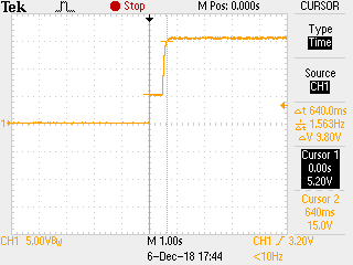

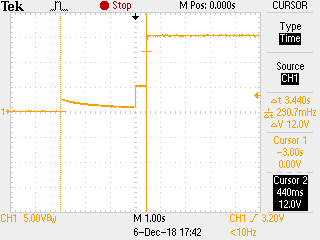

Power negotiation time is too slow over 3 sec for a kind of charger (A); from connecting the USB plug to getting the 15V output; while another model B charger gets less than 1 sec.
Model A charger Model B charger
3.5 sec 0.6 sec

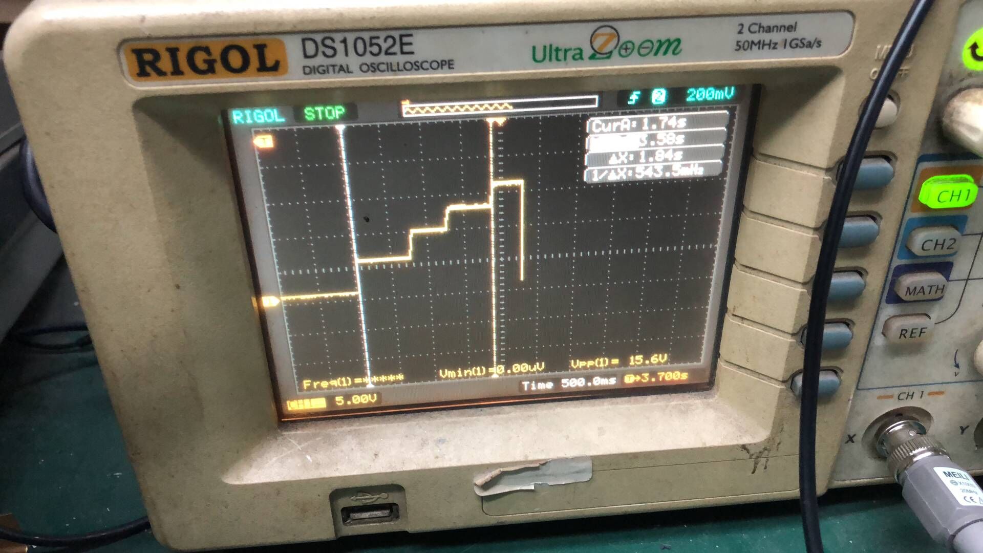

Of course, I argued the model A charger manufacturer. But they claimed their product is no problem with another battery-powered device like this photo.
Would you advise me how to speed up the PD response time with the (A) charger?

    I see that the issue lies with the power adaptor A. It's providing around 2.5V to start with, which is wrong.
    A PD source should provide less than 800mv upon connection untill Rp and Rd are detected.
    If you see the waveform of adaptor A then you'll find that the VBUS voltage is discharging slowly after the connection and the negotiation happens quickly once it reaches around 800mV.
