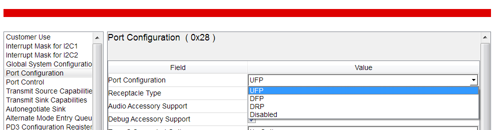

  • Hi Cun,
    What'[s your actual need? It's not very clear from your description.
    Are you looking to configure the 87D device as a PD sink? If that's what you want then configure it as a sink. Do do this please choose UFP in the Port Configuration field of Port Configuration register.

  • Hi Cun,
    If you choose the setting as UFP then the PD controller will connect Rd on the CC lines and of it's set to DFP then it connects Rp on the CC lines. However, note that the PD controller can't apply Ra from inside, that's needs to be taken care by your system.
    Do let me know if you have further questions.
