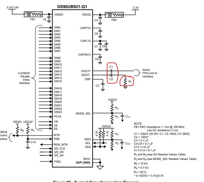

Hi Team,
My customer is using the DS90UB921-Q1 from RGB to COAX.
One question related to the capacitor and resistor layout goes that:
where is the best position to put the C1, C2 and R7? is it better to put it closer to the silicon or the FAKRA connector?
Any impedance control requirement?
