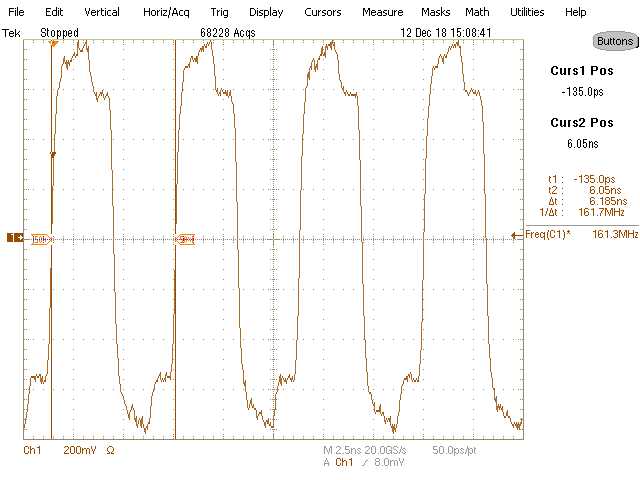

We measured frequency from TLK10232 ,  it's not correspond to our expectation ( 161.3  != 156.25 MHz)
Please tell a solution to receive the expected 156.25 MHz.

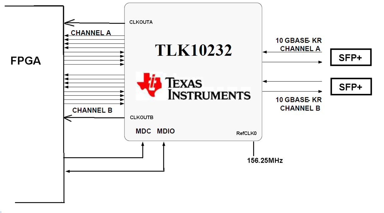

    In my case 156.25MHz is connected to Refclk0P/N like your schematic.
    In REFCLK1 P/N i have a second 156.25MHz clock but i don't use it (REGISTER 0x1E.0x0001 bit (1) REFCLK_SW_SEL = 0).
    With parameters that i gave you, CLKOUT(A) and CLKOUT(B) = 156.25MHz.
    My LS side is connected to a FPGA. So In my fpga i use CLKOUT(A/B) as clock input.
    Clkout (A) is an input clock for channel A LS side & CLKOUT(B) is an input clock for channel B LS side.
    And FPGA use CLKOUT(A/B) to generate 3.125Gbp/s data in the LS SIDE (in my case i use it in a 10GB-KR application).
    About HS side clock, it's just necessary to configure pll multiplier of  HS_SERDES_CONTROL_1 register.
    in my case HS_PLL_MULT[3:0] = 1100 (PLL Multiplier factor = 16.5).

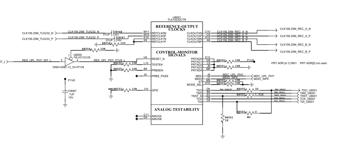

    Can you please send a schematic like the picture in attachment because i have difficulty to understand your question. Why do you speak about loop.
    Here schematic of my system.
    1/ At startup, FPGA configure all register of TLK10232 by MDC / MDIO bus.
    2/ When configuration is finish, CLKOUT(A/B) = 156.25MHz. TLK10232 use REFCLK0 (not connected to FPGA) to generate clock at FPGA.
    The combination of 156.25MHz TLK10232 input (refclk0)  and register configuration give a 156.25MHz at CLKOUT(A/B) pin.
    3/ FPGA clock input is 156.25MHz and use this frequency to generate 3.125Gbps data on the LS side. HS side run @10 gbps due to TLK10232

    Could you add some details to your schematic ?
    Source for refClk0 ?
    What source FPGA used until TLK10232 configuration ?
    Source for refclko = Silicon Labs SI510 CRYSTAL OSCILLATOR.
    FPGA use an others oscillator (25MHz) for only MDIO communication. This clock is always active after power is on.

    4/ You check that clkout from TLK10232 is correctly set at 156.25MHz or not (with an oscilloscope).
    So after step 4 :
    -- if clkout = 156.25Mhz, your problem was CLKOUT_SEL and CLKOUT_DIV values.
    -- if Clkout = 161.3MHz, CLKOUT_SEL and CLKOUT_DIV registers was not your problem.
    You have an other problem that you need to find.
