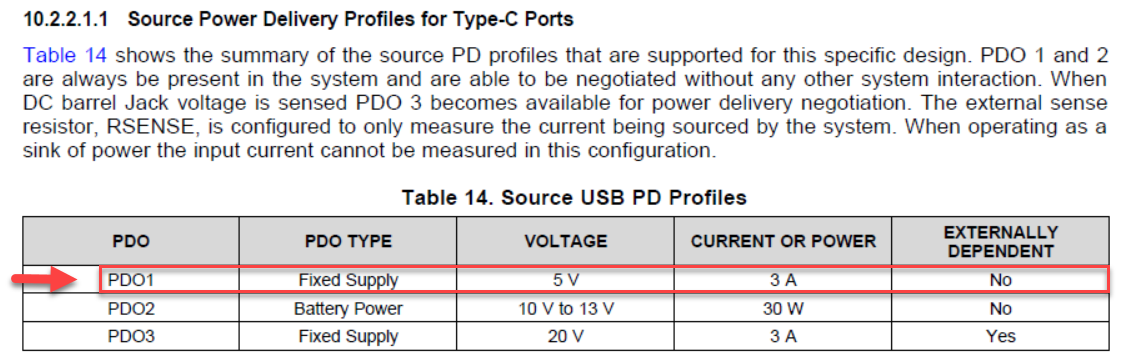

We have some questions need to ask you for advice.
1. Thunderbolt type C we only use 3A@5V, will not use 6~20V, please help confirm the TPS65983B setting.
2. If it is 3A@5V output, is TPS65983B limiting 3A by itself?
3. PW_VCCHV_SYS is not supported. What should I do with SENSEP/SENSEN (ball B10, A10)?
4. HV_GATE1/2 (A9/B9) does not support 6~20V. What should I do?

  • Hi AJ,
    The TPS65983B is only supported in device designs that are following one of the Intel Reference designs. No changes are supported outside of those reference designs. If you are not following an Intel reference design, another PD controller should be used. Recommendation is to look into the TPS65987D.
