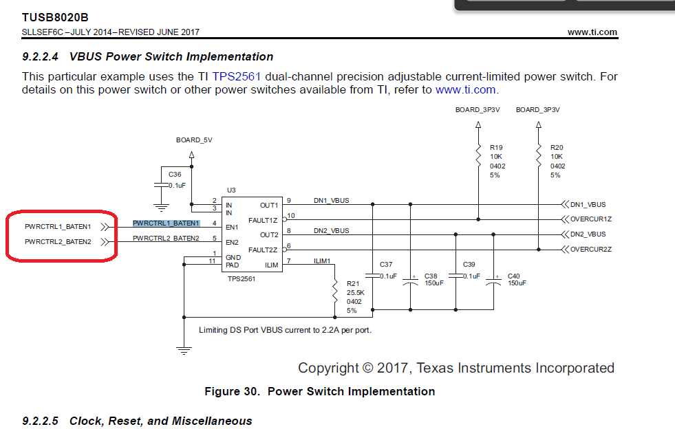

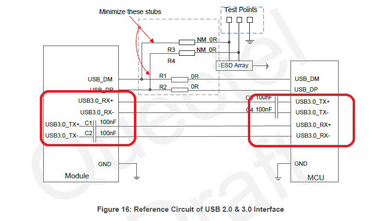

We are using Marvell CPU and that interface would come to TUSB3020B and then the down stream ports i am connecting to the LTE modules for the USB interface, which only needs the USB3.0 interface. Not power switching is required as we are not using USB connectors. Separate power management is done for the LTE modules.
For this kind of application do i need to have the power switch and the GNAGED and FULLPWRMANGEMNT pin to be grounded or left open, please see below.
  • No, if the ports are permanently connected you do not need to use the PWRCTLx outputs or the OVERCURx inputs. The setting of GANGED is a don't care in the this case and FULLPWRMGMTz should be pulled high.

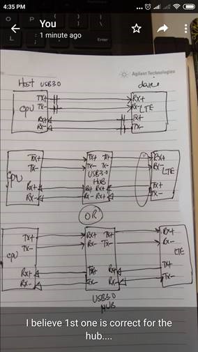

  • I would like to confirm that the USB 3 interface to the LTE module from CPU has to be swapped for RX to TX and TX to RX, so it has to be swapped on both ends ( 1:2 mux) of the USB3.0 hub ports right?
    CPU is the host and LTE is device, directly connected all the time, external power for the LTE and USB would be used. Please help to confirm as it's important for the design.
     The attached is for reference as what we had for the original design for the USB between CPU and module, now we want to add the hub in between.
    The TUSB8020B is not like a mux or splitter. It is an active part of the USB system, so RX of the upstream port goes to TX of the host and TX of the upstream port goes to the RX of the host. Likewise, the RX of the downstream port goes to TX of the device and TX of the downstream port goes to RX of the device. It would look like the bottom drawing in the photo that was attached.
