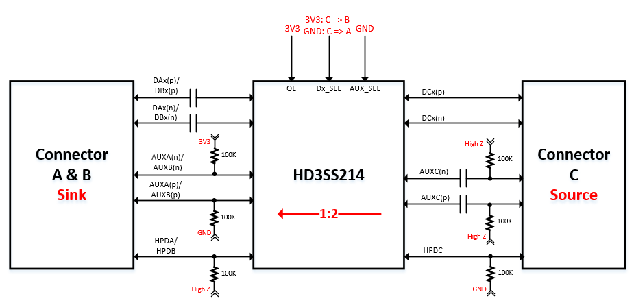

I am implementing a project using HD3SS214. I use this chip to switch between 2 monitors.
The schematic is shown below:
I have finished making the PCB board. I'm testing it, but I meet a problem.
First, after turn on the OE pin of HD3SS214, I change Dx_SEL pins to the mode "C to A", the desktop is shown on monitor 1, but after I switch to the mode "C to B", the monitor 2 blinks in 15 seconds before being stable.
Then I change to monitor 1 again, the monitor 1 now also blinking.
I have tested many times, the monitor always blinks before being stable except for the first time after turn the power on.
I wonder that problem caused by our design or that is usual.
