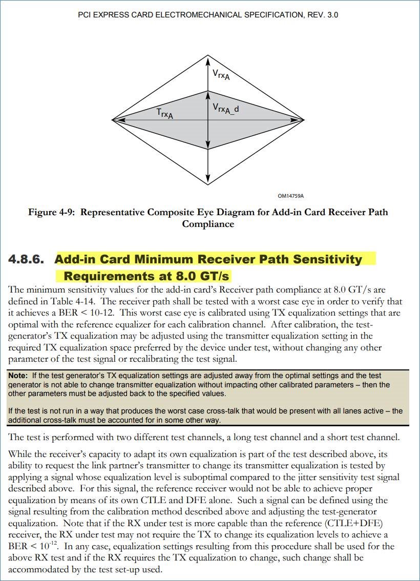

Our customer is using DS80PCI800, and they want to ask a question.
For our spec, the signal detect assert/deassert level is 180mV and 110mV.
But in PCIe CEM spec, the Vrx-eh-8g is 34mV. (please see the below figures)
Customers want to know why the difference is so much?? Why the TI spec is so strict?? Or what is intention to??
  • The eye height is only the inner eye amplitude.  The signal detect voltage is refering to a clock only pattern.  When the signal detect function is working with actual PCIe data at 8 Gbps the detection voltage is much lower.   For PCIe applications we recommend the default setting for signal detect.  It is used for 99% of redriver applications in PCIe.
