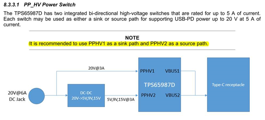

Hi team,
Please kindly help answer our costumer questions as below shows:
"If considering TPS65987D design, we will define PPHV1 and PPHV2 both as source path. I find there have recommendation wording about PPHV utilization. Do you have any concern about below desired power diagram?"
