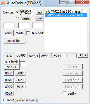

I use DS90UB913A-Q1 I2C Reverse channel update the camera firmware, But it always failed. (Freq=360K) .
The  solution is OV10640 + OV490 + DS90UB913,   ds90ub913 use PCLK mode.
After power-on, I will make the following settings to open the I2C channel. Then use the OV upgrade software to operate. Some cameras have been upgraded and failed.
Please help me analyze if I2C has other settings.
         0xC0 0x07 0xB0
         0xC0 0x08 0x48
         0xC0 0x10 0x48
        0xB0 0x11 0x0E
        0xB0 0x12 0x1A
        0xB0 0x14 0x02
