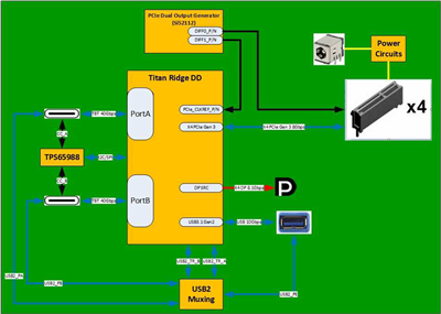

Hi team,
On the Intel titan ridge reference design, it shows that TR have one PCIe Gen 3, one DP and one USB3.1 Gen 2 output as below shows:
if there is a docking which have two hub (one gen 1, 4 port hub/ one gen 2, 4 port hub),
How to design relative position between hub and titan ridge?
Is it possible that two hubs all connect to TR's USB3.1 gen 2 output or one of the hub have to connect to TR's PCIe output?
It would be very appreciated if you could provide an brief block diagram to demonstrate the solution.

  • Hi Jamie,
    There are three options.
    1. You can connect the USB3.1 gen2 to the output of the USB2 muxes and U0_SSTX/RX from the ridge and cascade the gen1 hub from one of the downstream ports from the gen2 hub
    2. You can put the gen2 hub on the PCIe with a bridge and use the output of the USB2 muxes and U0_SSTX/RX from the ridge for the gen1 hub
    3. Or you could try the gen2 hub on the PCIe and cascade the gen1 hub
