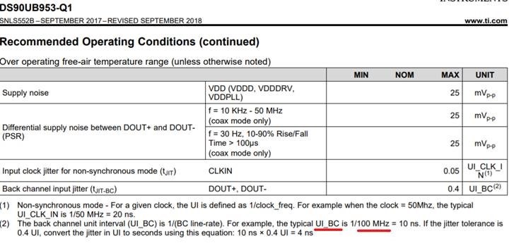

Hello Team,
DS90UB953-Q1 Back channel input jitter (tJIT-BC) note 2 shows that typical UI_BC is 100MHz. But DS90UB954-Q1 default back channel frequency is 50Mbps (UI = 20ns). So with default 50Mbps back channel rate, DS90UB953-Q1 back channel input jitter maximum should be 0.4 x 20ns = 8ns?
Thank you,
Jimmy
  • Jimmy,
    it is typo. if you measure the back channel data rate in default mode from UB954 output (dis-connecting with UB953), it should be 100Mbps. so the spec. in the table is correct. we would adjust it in new d/s. btw, do you have issue on back channel? For TI, if the transmission channel parameter can be met, the BC jitter should be under control. thanks.
