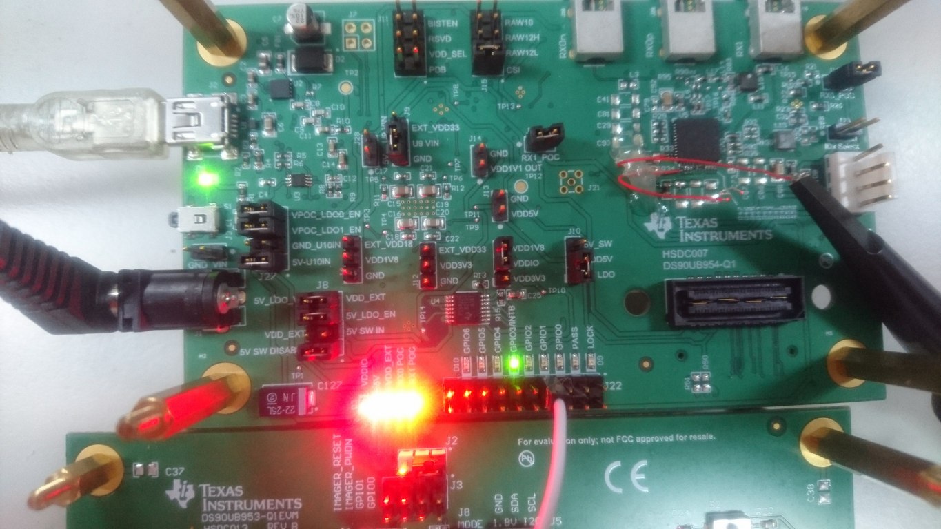

My customer is testing 953/954 EVM and found the CLK signal cannot get sync with input signal.
The testing configuration is:
1. EVM: DS90UB953 and DS90UB954
2. cable: RG316 coaxial cable around 10m length
3. use fly wire around 5cm form sensor to 953 EVM
4. input MIPI signal: 1 Lane/800MHz
Then they found the CLK signal is different with original, but data seems OK.
The LEDs on EVM as below.
Please help to give me some suggestion to get link work.
