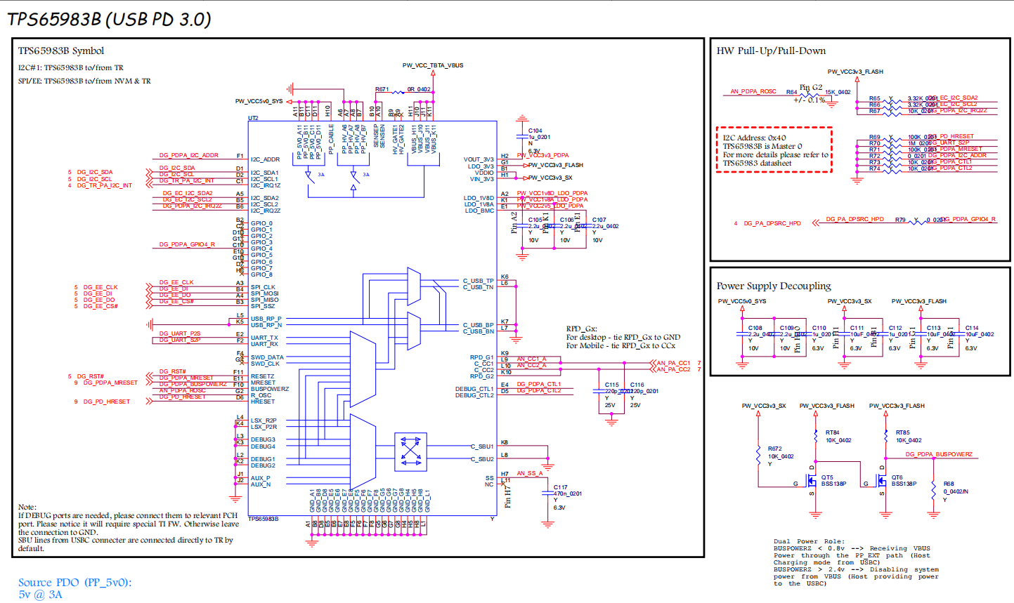

Hi Support
Could you help me check the schematic and below question, with Intel TBT3 Titan Ridge, do PD. Just output 5V/3A.
Please also confirm the following questions.
1. What is the use of MRESET and HRESET separately?
The Datasheet is not clear, Could you more explanation?
What should I do with the line?
2. We don't have an EC. What should I do with the I2C2 function pin?
  • Hi Yu,
    Please refer our EVM and USB Type-C™ and Power Delivery Multiport Adapter Reference Design (www.ti.com/.../TIDA-03027) to finalize your schematics.
    Answer to your queries are as follows:
    HRESET: This pin is the hardware reset of the PD controller, will reset the PD controller when pulled high.
    MRESET: This pin is used in thunderboth (TBT) systems. It causes the TBT chip to reset when toggles. Mostly it wont be used in your design.
    Just connect pull-ups on it and leave.
    Please click "This resolves my issue" if I was able to answer your query.
