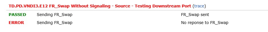

customer reported the following 2 questions about TPS65987D compliance test.
Can team review the issues and advise about the what setting missing in FW.

    According to testing lab about the item TD.PD.VND13.E12, if device does not support fast swapping, device need response "REJECT"  not "No reponse to FR_Swap" . Can you review it and suggest the configuration in FW?
    is the TD.PD.SRC.E16 issue due to VBUS discharge time too long? customer goes coupling capacitor design as the same as reference design. Can you review it and suggest your comments?
  • Hi Peter.
    I think this is just a Vendor Info File error for the first one. I suggest you use the latest from usb.org
    www.usb.org/.../VendorInfoFileGeneratorRelease.1.2.4.0.zip
    For the second issue it may be with your variable DC/DC. The transition from 5V to 12V is correct but it fails when transitioning down. The voltage on the power path may be too high to send PSRDY. You should check the voltage from your supply to confirm it is not higher than 5V.

  • Hi Team,
    For reference you need to only run RC or Stable tests for certification.
    You should run this specific test while looking at the voltage on VBUS and your varaiable DC/DC. PSRDY is only sent when the voltage has reached the PD contract value.
    How are you controlling the variable DC/DC?
