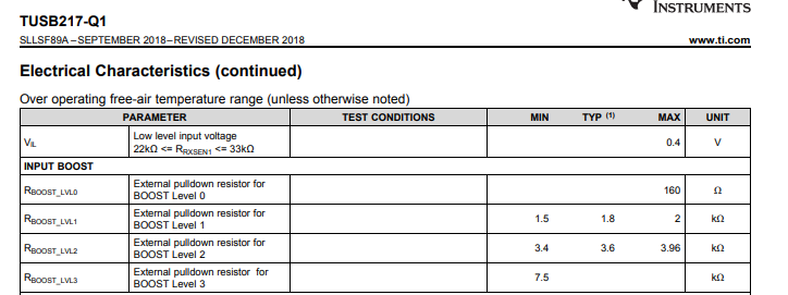

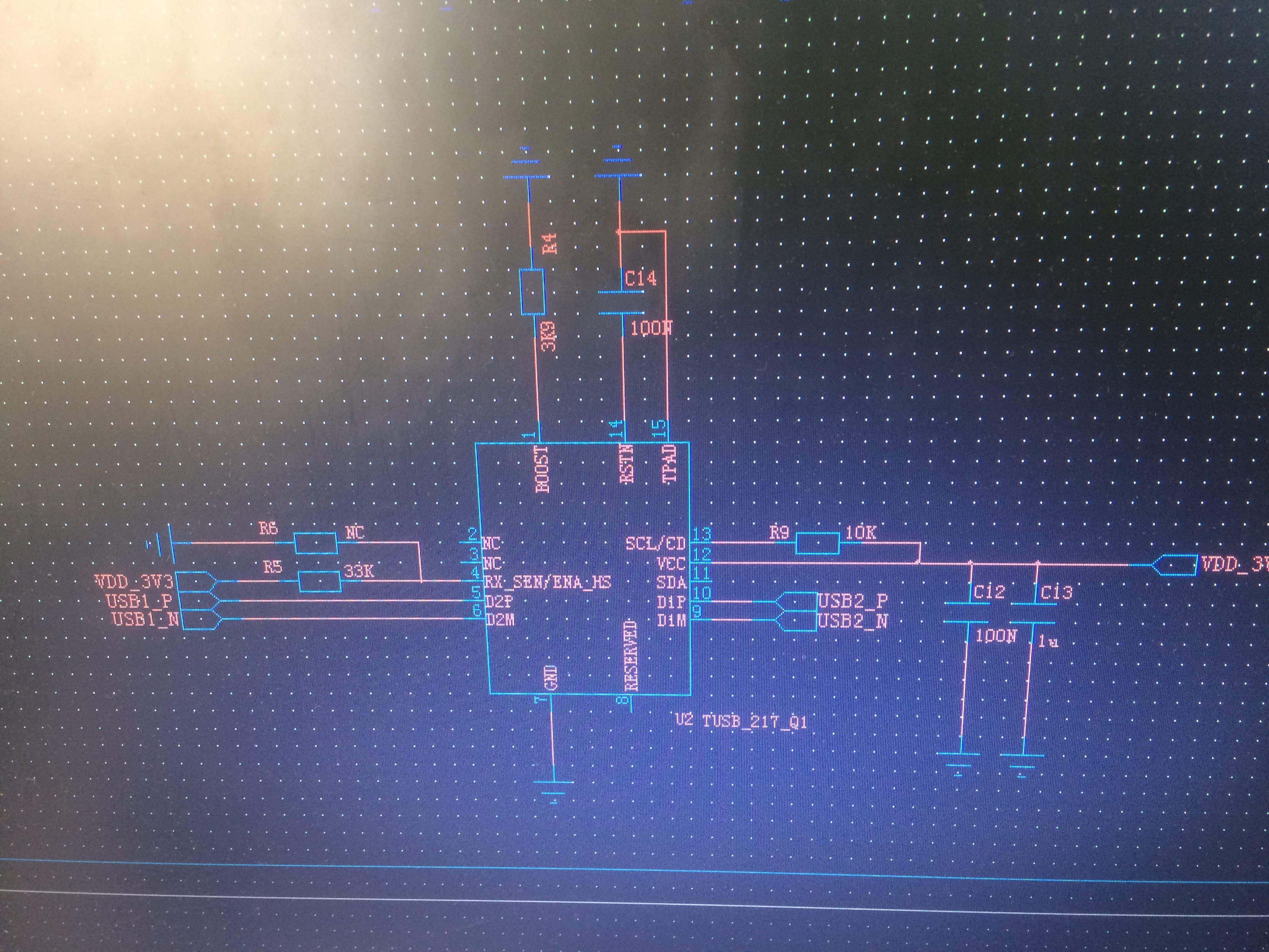

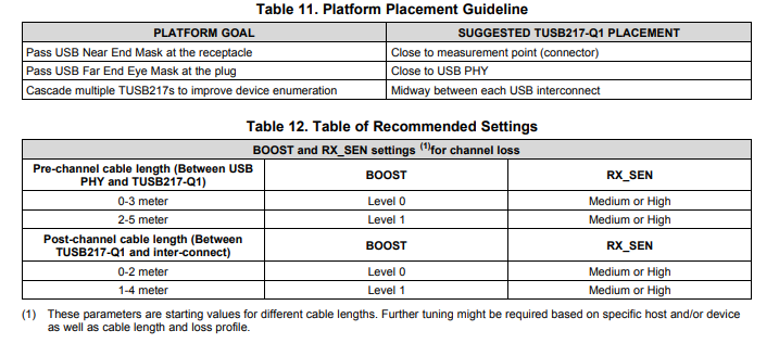

I uses TUSB217-Q1 to lengthen the communication distance. But when I mounted the part on the PCB, there is no any improved effect.
Could you please give us any suggestions about this case? Or do you have reference design about TUSB217-Q1?
