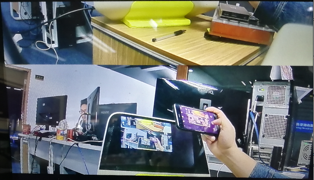

    Debugging ub964  question on iMX6 Linux platform encountered video image scrolling up and down, Please help to check what is the wrong setting?

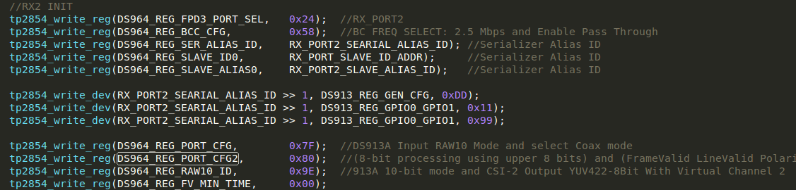

Our 964 configuration is as follows. Attached is the code for initialization and 964 configuration
The resolution set in the Linux driver is 1280x720, and the mipi clock  in one range is the same

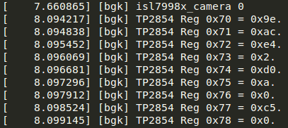

Reading back to register 0x70-0x78 confirms that the image resolution returned by the camera is 1280x720
