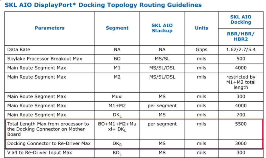

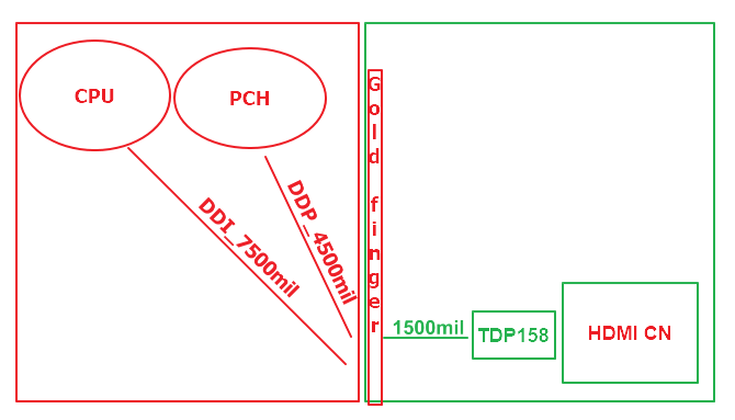

The picture below shows the TDP158 application designed by my customer. They want to know if the distance between the CPU and the TDP158 seems reasonable or not? (DDI bus refers to the data signals)
According to Intel's spec, 8500 mil seems to be the maximum acceptable length. Since the designed length is larger than the spec, do you think this would still work considering also the PCB and connector losses?
Thanks!
