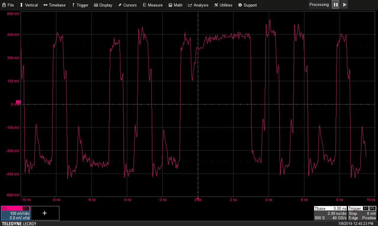

    Can you provide a schematic of your PHY portion, as well as all PHY registers during normal operation and in failure cases? Intermittent failure of communications is rarely related to the PHY, but could happen.
    If you are connecting a PC, the PHY MUST have RX_CTRL strapped into mode 3, or have any EEE features on the PC DISABLED.
  • Hi Rob, thanks for your response.
    In summary, we have a similar issue that the other question, we executed a TFTP command then perform a power cycle. It can keep working for random number of successful attempts, but sometimes we get an  ARP error message "ARP Retry count exceeded; starting again" after we try to transfer a file unsuccesfully using TFTP...
    I am attaching 5 files:
    - ForTI_Board_AN_PC_AN_ExtReg_WORKING_Part.log: This is the Phy reg dump when the TFTP worked
    After configuration during initialization

    - SGMII_LAB (RX yellow, TX pink)-001.jpg: SGMII RX waveforms (yellow one) but bad-looking TX waveforms (pink one)

  • Hi Ector,
    This is great information you sent in the registers, thank you.
    From what I am seeing in your registers, the CDR loop of the SGMII has changed PI index. Basically it seems like your SGMII PLL inside the PHY has lost lock. When that occurs, the SGMII auto-neg needs to start over and you may have lost data connectivity at that time.
    Your signaling looks less than ideal on the TX side as well, this may be why the 867 CDR may be losing lock.
    Where are your AC coupling caps physically located on the TX pair? If they are not very close to the pins of either package, reflections could be at fault for the ripple you see.

    Before I see your reply the Hardware team sent me a question and a comment about the diff pair net lengths for you:
    "Could you ask TI if the PHY has an internal 100 ohm differential termination for the SGMII input?
    Also if they ask, the diff pair net lengths are less than 2 inches long."

  • Hi again Rob,
    I have these more questions and answers for your questions from our HW team:
    "Can we ask TI what the min and max differential voltage amplitude specs are on the SGMII RX coming into the PHY? I don't see it in the datasheet.
    Also can we ask them to clarify...when they say "SGMII PLL inside the PHY has lost lock"...they are talking about the clock recovery on the SGMII RX coming into the PHY, correct?
    Also, to answer their question, you can tell them our AC coupling caps are located close to the transmitter, and our scope probe is located there, which is why there are some reflections seen in the waveform. I simulated the channel and the simulated waveform at the coupling capacitors matches what I see on my scope, while the simulated waveform at the receiver (PHY) die looks excellent. So it makes me think the waveform quality at the SGMII RX coming into the PHY is good in reality."

  • Ector,
    I will have to answer your questions in turn here, sorry that there will be 3 replies.
    Yes, we have a termination inside of the PHY. A 100ohm termination is not needed externally.
    Diff pair length less than 2 inches aren't an issue. Traces can be very long for SGMII, which is based on LVDS signaling. Intra-pair skew must be limited to 20ps as per SGMII standard.
  • xGMII errors can be caused by multiple sources, including the SGMII CDR losing lock. I think it gives more evidence to the idea that the SGMII signaling is less than ideal.
  • Ector,
    The PHY complies to the SGMII specification. It can be found with a quick Google search. I do not wish to distribute it here. All the electrical specs are there.
    Got it that the probing was done at the coupling caps and may be excellent at the PHY if simulation has been done. Is it possible to probe at the PHY to look at the signaling?
    Can you provide the PHY portion of your schematic? I didn't see it from my earlier request. I'd like to ensure your reference clock to the PHY is within specs, as well as filtering of your supply pins.
    Finally, do you see the xGMII error occurring without doing the TFTP transfer? SGMII and 1000base-T are always sending idle pulses, so the loss of SGMII lock should not be dependent on data transmission at all.
  • Thanks Rob for your answers!
    I will pass your comments to HW team...
    On the other hand, they have a waveform with pre and post-emphasis gone.  See above. Here are his comments "If TI wants to see it, attached is the waveform on the SGMII coming into the PHY, with pre-emphasis gone.  In my email below I was calling it "SGMII RX coming into the PHY", because from the PHY's perspective on the SGMII link it is the receiver on that diff pair.  However when the PHY is receiving SGMII data, that is a transmit from the MAC.  So the terms "RX" and "TX" can get confusing I guess.  Anyway I hope it is clear. As I mentioned below, our AC coupling caps are located close to the transmitter, and our scope probe is located there, which is why there are some reflections seen in the waveform.  I simulated the channel and the simulated waveform at the coupling capacitors matches what I see on my scope, while the simulated waveform at the receiver (PHY) die looks excellent.  So it makes me think the waveform quality at the SGMII RX coming into the PHY is good in reality."
    They have other questions:

  • Hi Ector,
    The PHY can loopback data to the MAC in SGMII mode using the digital loopback, or the MII loopback methods. MII loopback is controlled by bit[14] in register 0x0.
    Digital loopback is controlled by bit field [5:2] in register 0x16.
    These loops should not be active at the same time. Note in table 4 of the datasheet, loopback availability, that your link status will not show a link up in MII loopback mode. In digital loopback mode the link status will show as good.
  • Thanks Rob,
    I will ask same question again becuase still is not clear for me why we are getting the xGMII error interrupt when the problem occurss. ..
    The Phy register 0x13 had the value of 0x0004 that is when xGMII Error Interrupt is pending, this is a pattern, we have this interrupt every time we have the issue with the TFTP. Could you please enumerate what are the possible causes of getting this interrupt when the TFTP fails?
    Ector
  • Hi Ector,
    The xGMII error interrupt is signaled by the SGMII RX/TX fifo overflow or underrun. This suggests a possible ppm offset between the 867 and the processor.
    Can you verify your reference clock to the DP83867 is within the 25MHz +/- 50ppm requirement? This frequency should be measured on the CLK_OUT pin so the probe loading does not pull the crystal.
