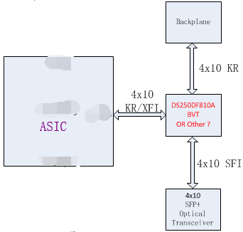

You mean DS250DF810 does not support 40G BASE-KR4?I also want to know if ASIC is configured as XFI protocol, can it connect 10G SFP + optical module after DS250DF810?
The application model is as follows:
best wishes,shaocong
Hi Shaocong,
DS250DF810 does not support 40G BASE-KR4. For this application, please consider DS100KR401 device.
DS250DF810 does support 10G SFP+ optical module.
Could you please include application model again? For some reason this was not visible in your earlier post.
