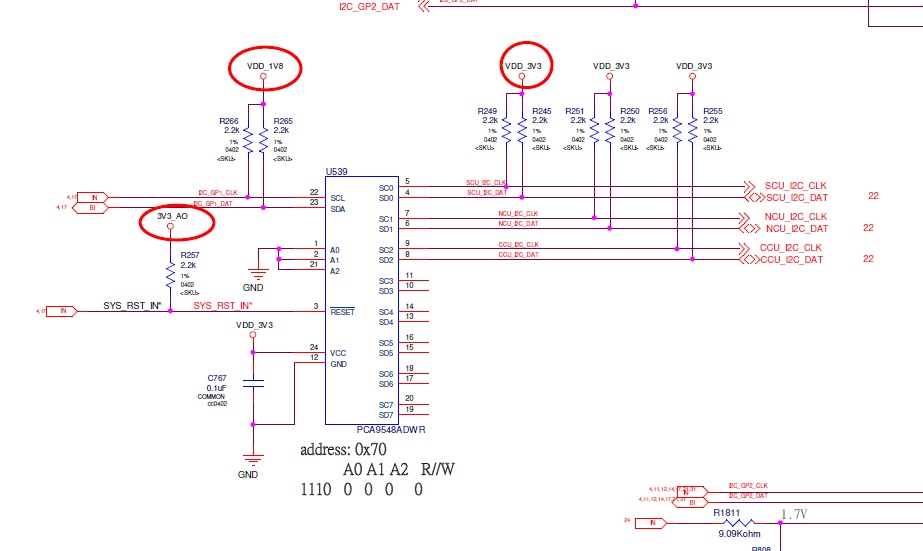

PCA9548A: Pull-up voltage level between SCL/SDA & SCn
Part Number: PCA9548A
Hi there:
I'd like to check an customer's application for PCA9548A.
Please refer the following picture from customer schematic.
We've known the VCC is 3.3V, 1.8V for SCL/SDA and 3.3V SC0~3
Is there any risk or suggestion for this different between those 2 voltage level?
