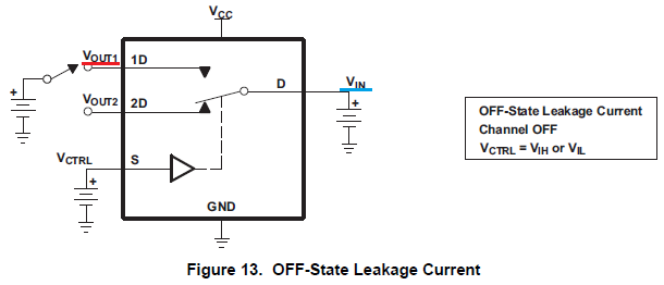

Hi Team,
I believe Figure 13 is test circuit for IOZ of electrical characteristics and blue and red underlines is correspond to Figure 13 as the following.
If so, what is green underline (VI = 0V) means?
Yaita

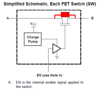

Hi David-san,
I appreicate for your reply.
I understand VI is data input, VO is data output, VIN=EN.
If so, I believe there isn't parastic diode (red part) of internal FET because of the following in datasheet.
>(3) For I/O ports, the parameter IOZ includes the input leakage current.
Is my understanding correct? Is it back to back connection?
Yaita
