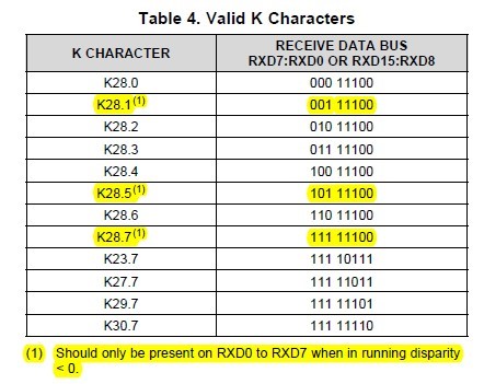

I use this simple protocol below work:
TDX7-TDX0 are fixed on K-code 28.5,
TDX15-TDX8 send counter like data,
But on this protocol when i send  K-code 28.5 between each data on TDX15-TDX8, it dont work:
TDX15-TDX8 data(after)K-code(after)data(after)K-code.........
it seem when i want to send in same time two k-code on TDX15-TDX0, it dont work?
