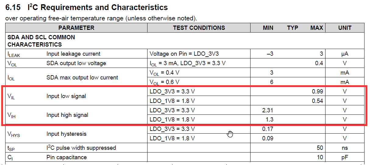

I would like to know if I can pull I2C/GPIO up to 1.8V or not. From below TPS65988 spec, it looks ok.
Do I need to modify PD firmware configuration also? If yes, please guide me how to configure it.
Thank you.
