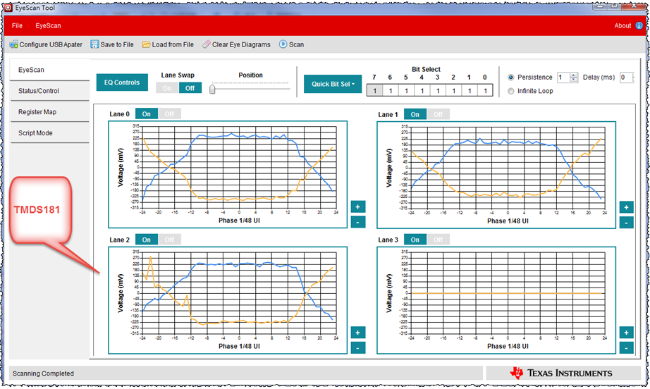

Hello.
We used DP159 got some problems in the test and would like to ask as follows.
1. I would like to ask why the DP159 has the following conditions. But the TMDS181 looks normal.
DP159
TMDS181
2. The eye diagram of DP159 cannot be Passed. Is there any other suggestions that can be set? Please kindly reference on below.

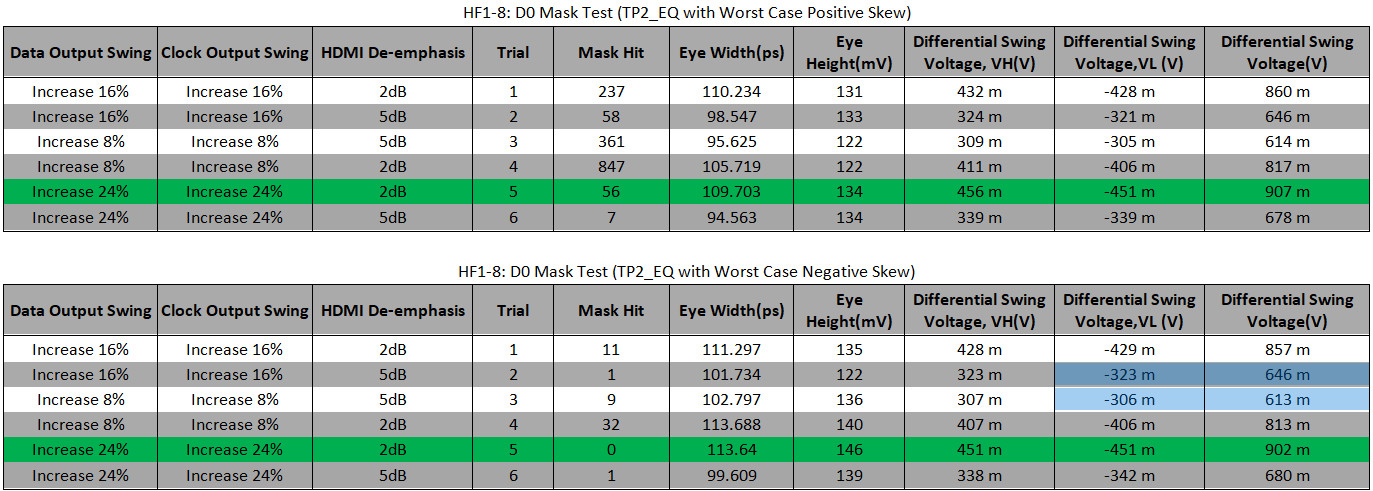

3. Can I set a 5dB pre-emphasis? The Eyescan GUI can be set. But 0x0C on SPEC is Reserved.

    Are you using the same source between DP159 and TMDS181 eye diagram? Would you please share a block diagram of your test setup?
    DP159 is a AC coupled input while TMDS181 is a DC coupled input.
    David

  • AJ
    This is a known issue with the EyeScan tool at HDMI2.0. Please take a look at page 11 of the TMDS181 EVM user guide: www.ti.com/.../sllu228a.pdf.
    David
  • Dear David.
    I got it. Thanks for kindly help. How about questions 2 and 3? Thank~
  • AJ
    May I take a look at your HDMI compliance report?
    5dB de-emphasis is removed from datasheet as it will cause compliance failure.
    David
  • Dear David.
    We don't have an HDMI compliance test report. Because there is no HDMI connector in this project. Thanks~
  • AJ
    How was this table generated and do you have the corresponding eye diagram for each row?
    David
  • Dear David.
    Please kindly reference on attached file. Thanks for help~

  • AJ
    Would you please save the report in *.mht format? This would preserve the eye diagram picture.
    If you don't have a HDMI connector for your project, how are you able to use Keysight N544A differential head for the signal measurement?
    David
  • Dear David.
    We are waiting for the PCB Layout to be revised version. If there is any problem will consult with you. Thank you~
