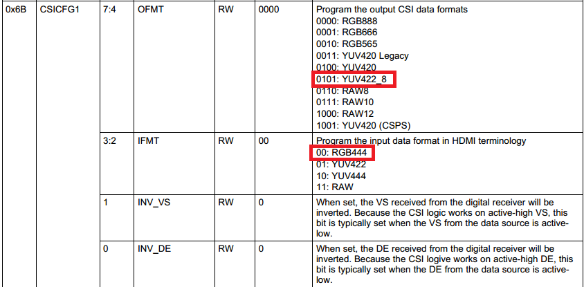

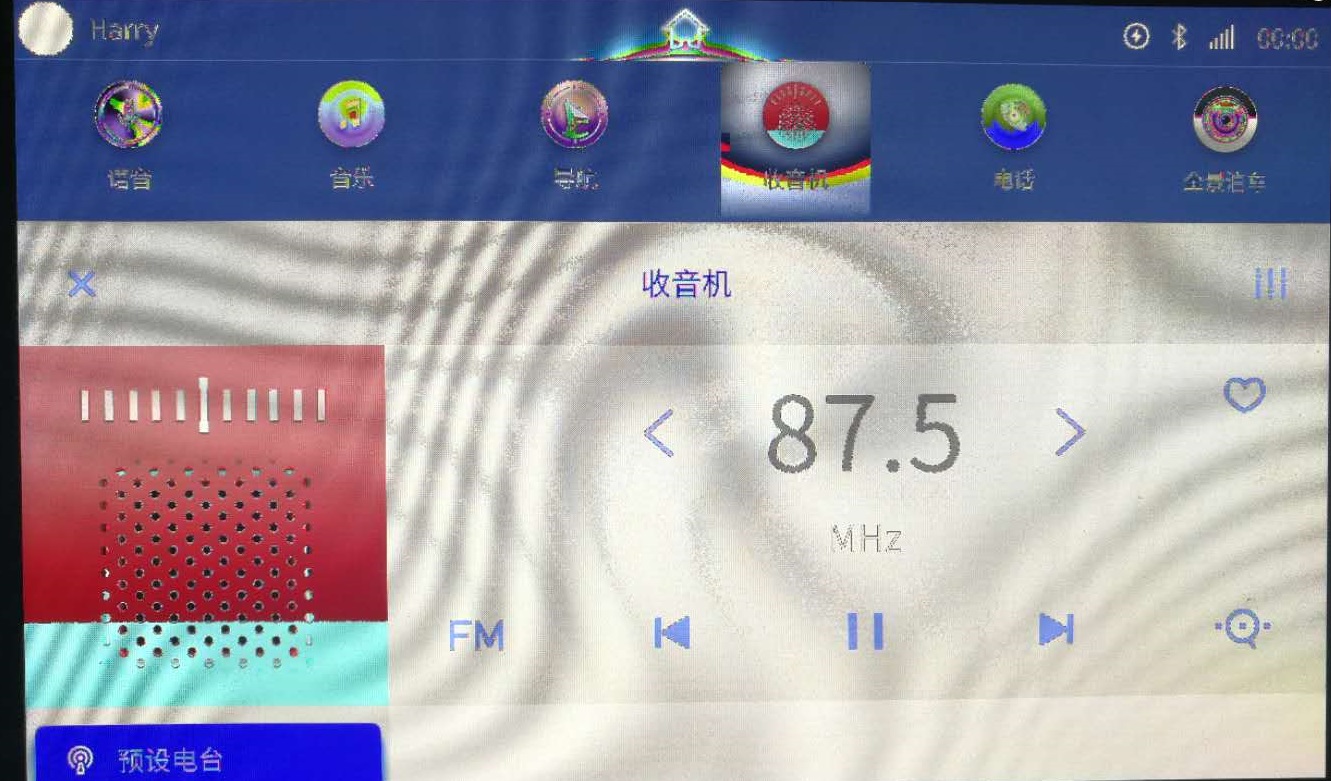

hello ,dear TI team
in this way, input video format rgb888 to ds90ub947 on openLID, pass FPD-Link III to ds90ub940,then at the last output Yuv422,
(rgb888--->openLID--->DS90UB947 --->FPD-Link III --->ds90ub940---MIPI CSI2--->Yuv422),the display interface has abnormal,
UI's contents display complete but the color is not right,to my fell that is the RGB's hight bits (one or more bits) was lost.
dose the ds90ub940 can support RGB888 format input, if can do it,how can i configure them.thanks!!
