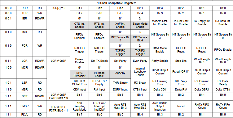

TL16C2752: I want more infomation or datasheet of TL16C2752.
Part Number: TL16C2752
Other Parts Discussed in Thread: TL16C752D
The datashet of TL16C2752 download from TI is not detailed.
Functional registers are not described in detail.
The length of reset time required is also not specified.
I would like to know more about the functional registers of the chip.
  • Hello user708206,
    "Functional registers are not described in detail."
    Sorry about that, these devices are a bit old and the documentation may be lacking on our older datasheets.
    For this, I would recommend looking at tl16c752D datasheet for the compatible registers.
    The ISR register should be the same as the IIR register. TRG should be TLR.
    If you need EMSR, FLVL, and FCTR , I'll need to poke around to see if I can find this. Let me know if you do.
    "The length of reset time required is also not specified."
    tl16c752D states 200ns so I would say multiplying this number by 2 should give us safe margin here. 400ns would likely be enough time for a proper reset.
