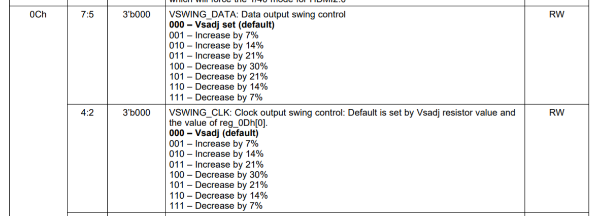

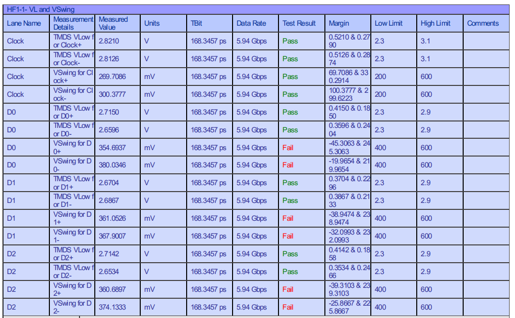

Dear Support
The customer has an issue about the below test result.
They need to increase the VSwing voltage to 400~600mV
I fond the RVSADJ is 4.5K to 7.06K but not more details, and register as same as.
Could you tell me how to adjustment VSwing voltage?
