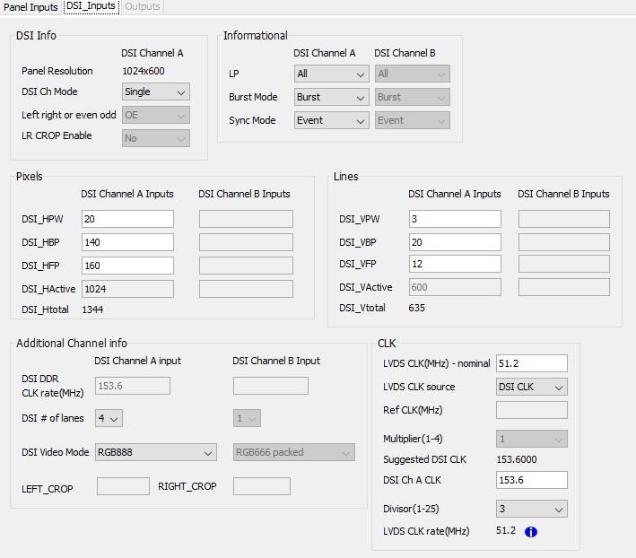

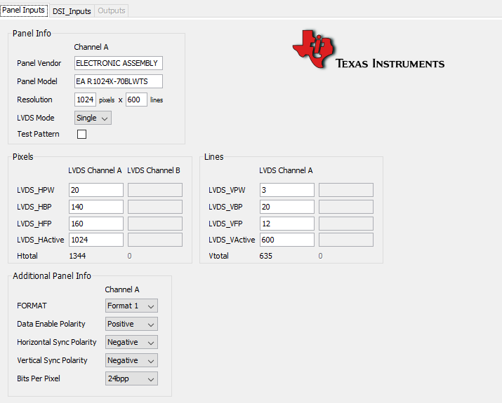

We are using SN65DSI83 to convert DSI to LVDS.
We have configured the registers according to CSR.txt output and setup PLL_EN and SOFT_RESET. We also tried different settings (18bpp, polarities etc) but with no luck.
Our display is 1024x600 and configured for 24bpp. I have attached the datasheet of the display.
Is there something wrong with our parameters?
Below you can find our configuration:
r1024x-b.pdf

  • Can you try experimenting with different polarities for data enable, HSYNC, and VSYNC? I can't really tell from the display datasheet what polarities it is expecting. For changing the polarities it'd be best to configure those registers manually rather than use the DSI-Tuner, because for some reason I think the tuner sticks with the default settings for these parameters no what how it's configured.
    I.K.
  • You are right. Those values make no difference when I change them from DSI Tuner.

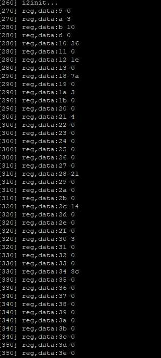

    1. Can you provide a register dump so I can take a look to see if any of the registers are being improperly written?

  • 1. I first write and then I crosscheck by reading the values:
    2. Using an actual DSI input stream requires modification to the input clock as you can see on the previous picture. Doing so results to 0x01 in register 0x5e.

    For your register values above, I can see that the PLL is not enabled (register 0x0A and 0x0D) which would explain why you're getting the PLL_UNLOCK error in register 0xE5. You are probably not getting any output on the display with this configuration correct? Please try again with the DSI input stream and ensure to enable the PLL while still abiding by the initialization sequence.
    Another point to check is the data format (bit 1 of register 0x18). Your display datasheet does not actually specify what format it is expecting, so you can try switching between format 1 and format 2 to see what the effect is. Please also ensure that your display is configured for the 8 bit option since you have 24bpp enabled in bit 3 of register 0x18.
