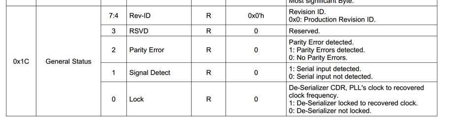

Dears:
The customer uses 914 in the system and have some question about the below information:
1.  Is there any influence if Lock/Signal Detect is 1 and Parity error is 0?
    Btw, the signal of BISTEN is low, then 914 is under PCLK MODE.   The frequency is 1280*960, and PCLK is 96MHz.
2. And customer sets the frequency is 720P, and PCLK is 74.25, the Parity Error is 0.
    If customer wants to realize the 1280*960, how could we do?
Pls. give some advice.
