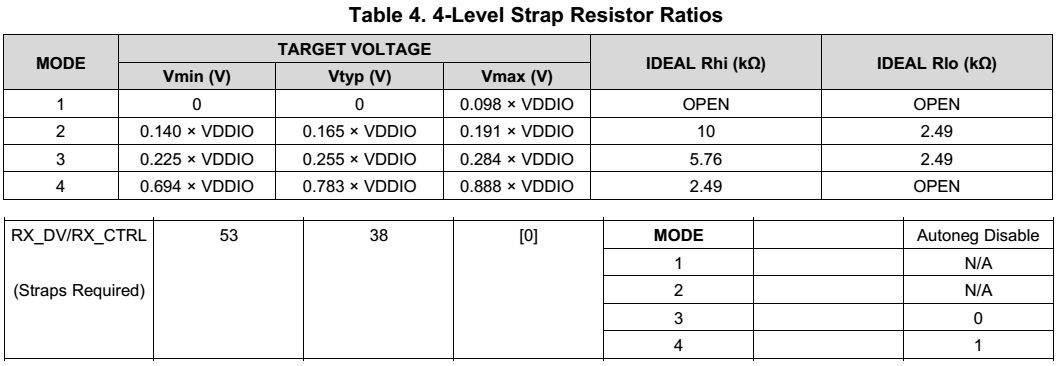

  • Hi Corey,
    Register 0x6E and 0x6F are defined in the datasheet.
    Can you tell me how you strap RX_DV/RX_CTRL pin on your board?
    Hung Nguyen

  • Hi Corey,
    If RX_DV/RX_CTRL pin is pulled down, the device is strapped to Not Applicable mode. We will not be able to guarantee PHY performance for Not Applicable mode.
    To enable Auto-Negotiation, RX_DV/RX_CTRL must be strapped to Mode 3.
    Hung Nguyen
  • Changed resistor values to suggested for Mode 3. same behavior.  ie no change in behavior.
  • Hi Corey,
    You need to read back register 0x6E and 0x6F to confirm the straps are indeed correct. Refer to datasheet section 8.4.2.1 for how to read extended registers.
    Hung Nguyen

    Strap is correct.

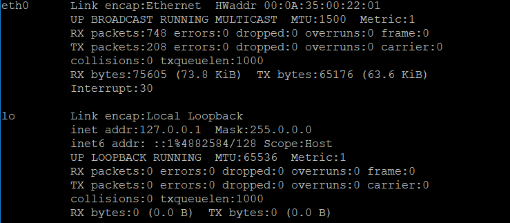

  • Seems this problem is still not over.  The LEDs for link and gigabit are working and blinking but alas I cannot get any traffic to get through the phy.
    No responses from ping, no dhcp, no setting static addresses and working.  the router cannot see the zynq board.  The router also shows a good connection and a link at 1Gbit, but no traffic.
  • Hi Corey,
    Good to hear that you can get the 1G link!
    The 2nd issue you're seeing seems to be related to the MAC interface. Your board is designed for RGMII mode which has different settings for delay on both TX and RX direction. Depending on whether the RGMII MAC has any internal delay, delay setting on the PHY side needs to be configured accordingly. Please refer to Table 8 and Table 9 in datasheet for more details on RGMII Clock Skew configuration.
    From strap register readout you provided earlier, 0x6F = 0x100 which means both TX and RX having 2ns clock skew. In this case, the RGMII MAC must have 0 clock skew for the RGMII interface to work properly.
    You can also use registers to control the clock skew. Refer to this RGMII app note www.ti.com/.../snla243.pdf
    Hung Nguyen
  • Exactly my problem. 0 clock skew is not realistic. I pushed it out to 2ns for both, and now i am in business. How should I set these skews if i do not have access to the routing and pcb information? Trial and error?
  • Hi Corey,
    I would suggest following this app note www.ti.com/.../snla243.pdf for more details regarding to RGMII timing on your system.
    Hung Nguyen

    Using RX_DV/RX_CTRL bootstarp mode 3 (and not 4) vitrified by 0x6e new val 0x05,
    I recommend to verify the bootstrap mode with register 0x6e, since the resistors set can have some inaccuracy,
    You can try to tune register with voltmeter readings hold the PHY in reset mode, according to bootstarp mode table.
    Master slave is also set to negotiation enable, verified by register 0x9 new val 0x300
    Now link is up, without any bit banging .
    Most driver automatically and independently set speed duplex auto negotiation, this fact mask the issue boostarp 4 is not recommended!!!
    The affect of bootstrap mode 3-4 on master/slave negotiation is unclear from pdf. seems that boot strap 3 enable master/slave negotiation as well.
