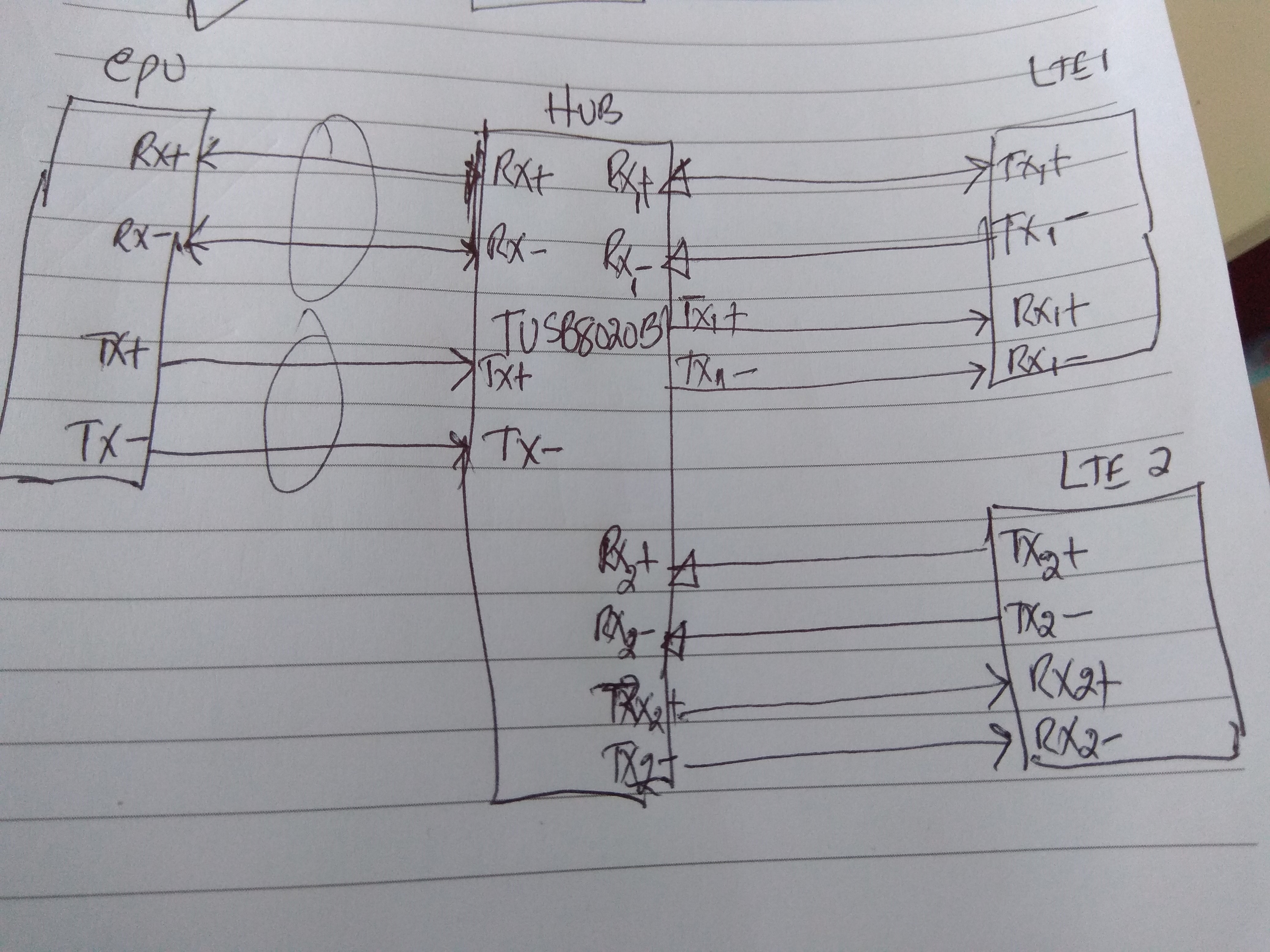

  •  Can you help to verify as this is my latest block.
  • Your direction on the TUSB8020B UFP is incorrect. The TX is output, the arrow needs to be pointed toward the CPU. The RX is input, the arrow needs to be pointed toward TUSB8020B.
    You also drawn the TUSB8020B as a mux representation, but TUSB8020B is a hub, not a mux.
    I don't know the I/O definition of CPU TX/RX and LTE TX/RX, so please double check the I/O definition of these signal to make sure which one is output and which one is input.
    The interface also needs to be AC coupled.
    David
  • Yes i know the direction was different by mistake. All i need to know is the connection of CPU to HUB and LTE..... Just look at the TX and RX from input and output as below picture.
  • I don't know the TX and RX definition for the CPU and LTE1/2. please don't look at TX and think it is an output and look at RX and think it is an input. It is better to check the CPU and LTE1/2 datasheet to make sure which one is being defined as output and which one is being defined as an input.
    If we assume CPU TX is an output, then it needs to be connected to hub RX, and CPU RX needs to be connected to hub TX. The connection between hub and LTE1/2 is OK assume TX is an output and RX is an input for LTE1/2.
    But this is just a assumption, it is better to check the datasheet for each device to make sure.

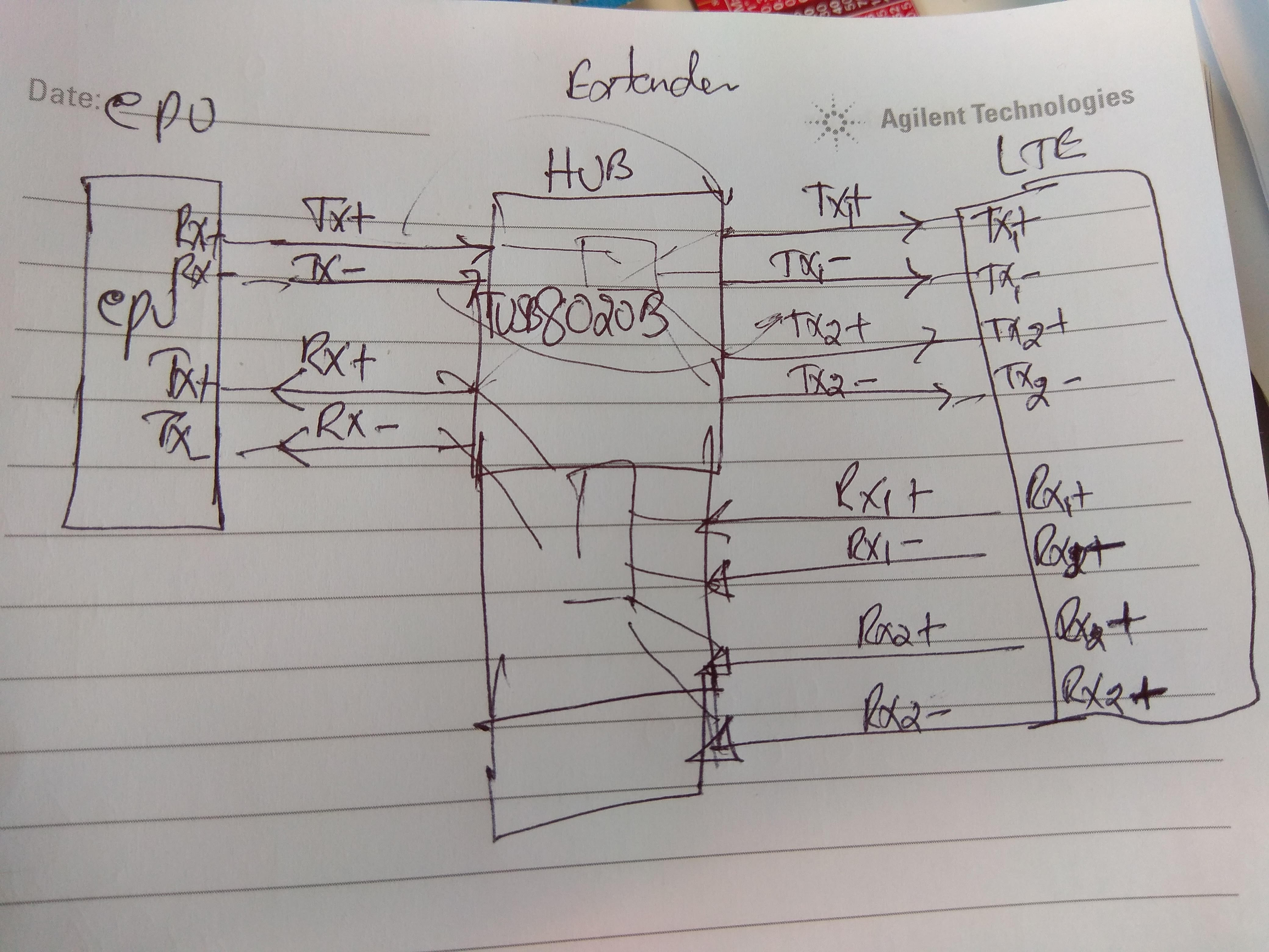

  • Hi David,
    If we are going to follow your suggestion, how would it work if we swap on both sides of the hub, please see my comments in red in the picture. Appreciate for your help to confirm.
                    if we follow TI suggestion, how would it work if we swap on both sides of the hub, please see me comments in red in the picture. confirm this with TI
  • The hub is not a USB extender. The hub RX will recover the SuperSpeed data sent by the CPU TX (assuming CPU TX in this case is the transmitter) and re-send the data out on its TX.
