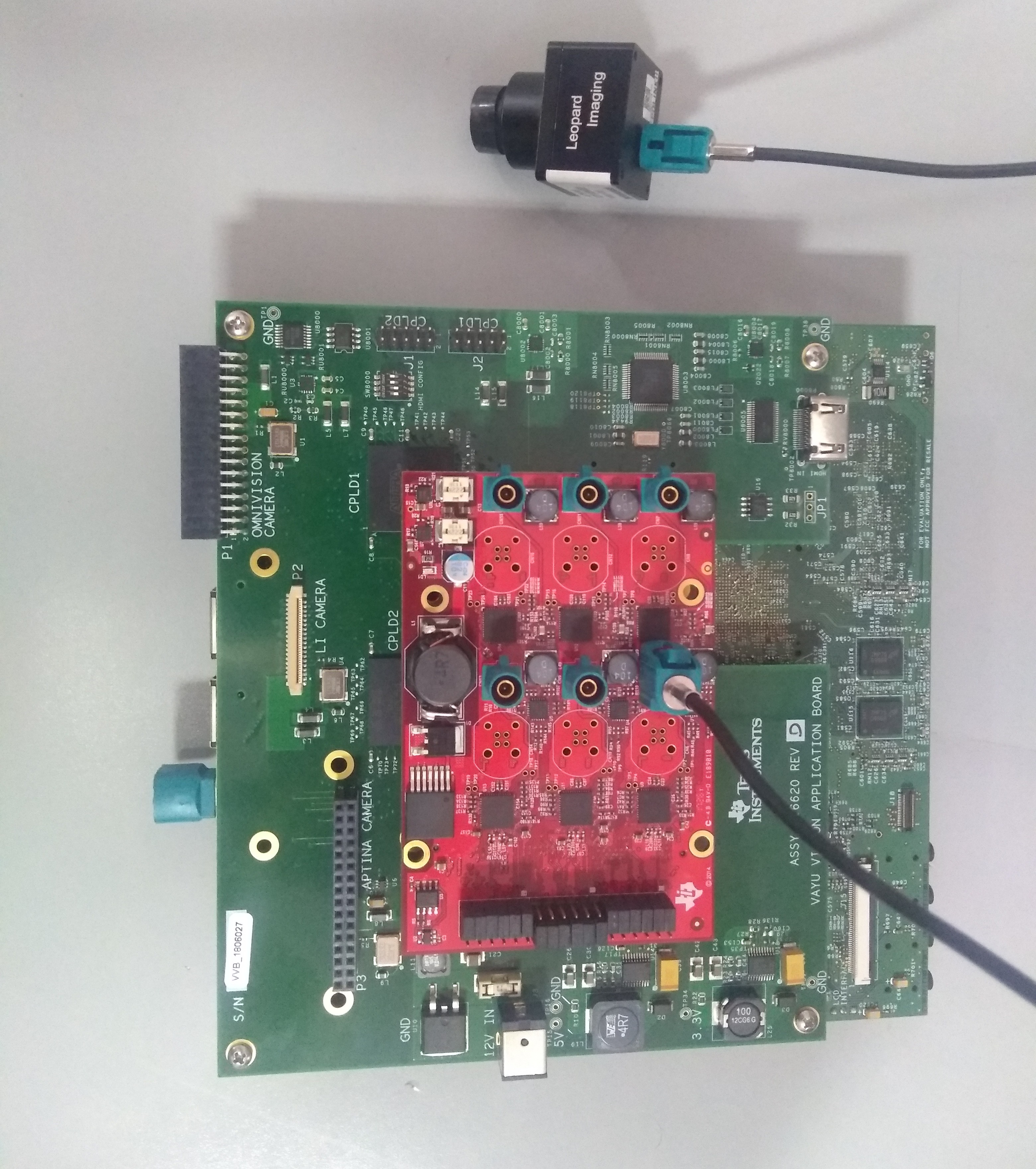

  • Thanks for sharing the document Charley.
    I need more information on the Hardware Checks. (shown in the Figure 2 of the document).
    I have attached a image showing my current hardware connections.
    Can you let me know where exactly the HW modifications needs to be made as shown in the document ?
    Uday M S
    1. AC coupling capacitors need to be placed at DOUT+/- (serializer side) an RIN+/- (deserializer side)
    2. Mode pin on the 953 needs to be strapped accordingly for DVP mode (reference the datasheet)
    3. The 953 MUST have an external oscillator for it's CLKIN (pin 20 on device, reference the datasheet)
    4. Ensure proper data format is selected on the 934 side (RAW10 or RAW12HF). Reference datasheet.
    You will need to locate the pins based on the datasheet and schematics for the board you have. If you are using the EVM, you can find the user guide to the EVM on the TI website to determine where the modifications need to be made.
  • Thanks Mostafa Shuva  for the reply.
    As you can see in the previous post, I don't have physical access to the Serializer in the camera component(OV2311 Sensor + 953 Ser) that I have got from Leopard Imaging.
    Is it possible to do the suggested changes outside the camera component (Over the cable) ?
    Uday M S
    The pin strapping for DVP mode can be set in the software over the link. However the AC coupling caps would need to be placed on the serializer, as well as the oscillator (if one doesn't exist already).
