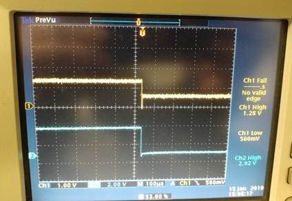

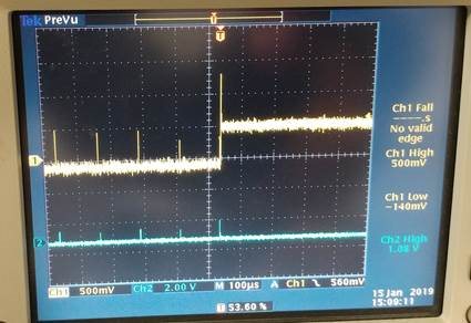

Should we expect TPS65987 would short DP and DM pin while BC1.2 is configured as DCP in 0x29 register?  Also this setting at host side(laptop) should not be workable with a USB2,0 disk?
PLease check below for the DP/DM measurement with them connected from type-c connector to TPS65987 while a USB2.0 disk is connected (through a type-c to type-A dongle).  These two waveform show the behavior of DP/DM while 0x29 BC1.2 setting is changed between DCP and CDP.  Customer said their laptop with such test can still detect the USB20 disk correctly.  Is it correct behavior?  Why?
DCP switched to CDP
CDP switched to DCP

  • Hi Antony,
    It looks like this is the correct behavior. Per the BC1.2 spec, the D+/D- lines will be released after the detection or advertisement is complete. The USB2.0 lines would then be free to enumerate the USB disk.
