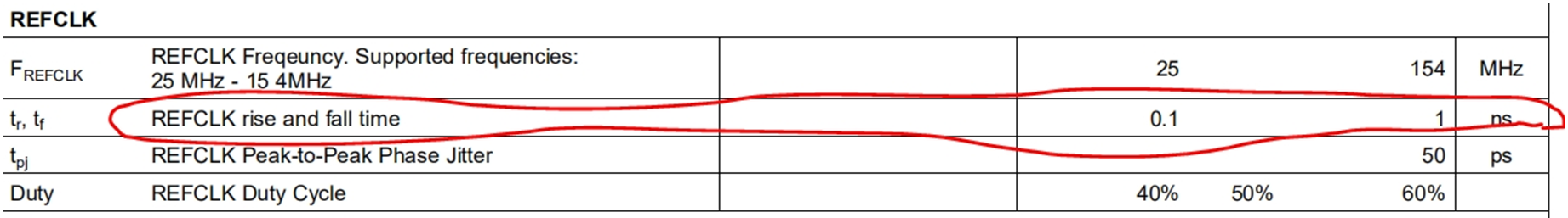

         2.REFCLK, recommended on EVM is 25-154 Mhz clock.
           We use 25 MHz active crystal oscillator.There is a time requirement for rise/fall in specifications.
           Is this 20%-80% VCC time or 30%-70% VCC time?

    2. I'm not sure I understand your question here. The minimum rise/fall time is 0.1ns and the maximum rise/fall time is 1ns for the REFCLK.
