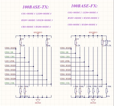

We are penetrating DP83822 in My customer, now they want to do loopback test, but didn't success till now, would you pls help check below schematic to help double check hardware is no problem, thanks!

    Firstly, would you pls help double confirm below schematic to make sure these is no problem from the hardware.
    Note, customer use RGMII and their design is compatible for both Copper port and Fiber port, below is the schematic and strap settings:
    DP83822HF Copper port and Fiber port.pdf
    2. For RGMII interface showed below, I already suggest customer to make sure the PCB trace length of TX_CLK and TX_D[3:0] are same, also make sure the PCB trace of RX_CLK and RX_D[3:0] are same, these are ok for customer. However, due to layout limitation, the length of TX pairs(Including CLK and data trace) and the length of RX pairs(Include CLK and data trace) are not same, will this be ok? Or they must be same length as well?
    3. Now customer is trying to do MII loopback with copper port, but it is failed. Would you kindly suggest the detailed procedure showing how to do MII loopback?
    4. When using Copper port and if we plan to do MII loopback, how to configure the pin 24(LED_1)?
    5. I think MII loopback mode should not only work for MII interface, should also work with RMII and RGMII mode, is this correct? If so, any different for RGMII       interface when we want to do MII loopback.
    Thanks a lot for your kindly support! Customer is pushing project schedule, need team's great support on this.

  • Hi Sulyn,
    - RGMII trace length matching is only needed within TX pins or RX pins. In other words, TX pins don't need to be length matched to RX pins.
    - When you said loopback fails, what does it fail? Please also provide register configuration to enable loopback.
    - Can you provide the value for the following registers: 0x467, 0x468 and 0x17
