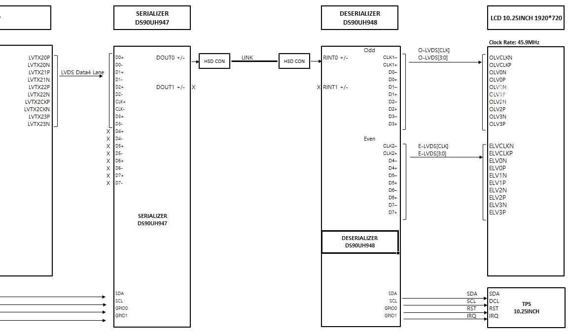

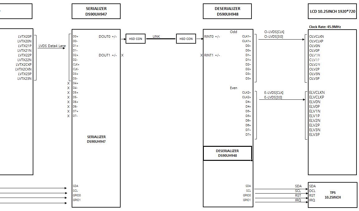

Hi team
My customer want to configure Dual LVDS LCD(1920*720) solution as below.
I have a few questions about the blocks below.
1. Is there any problem when it is configured as below?
2. If the TFT LCD Clock Rate is 45.9MHz, should input Clock Rte of DS90UH947 be set to 91.8MHz(45.9MHz x2)?
3. Is there a recommended specification for the connector between the DS90UH947 and DS90UH948?  If it have, suggest please.
4. Please suggest a product that can configure Serializer to RGB24Bit input and make De-Serializer output as Dual LVDS (1920 * 720).
