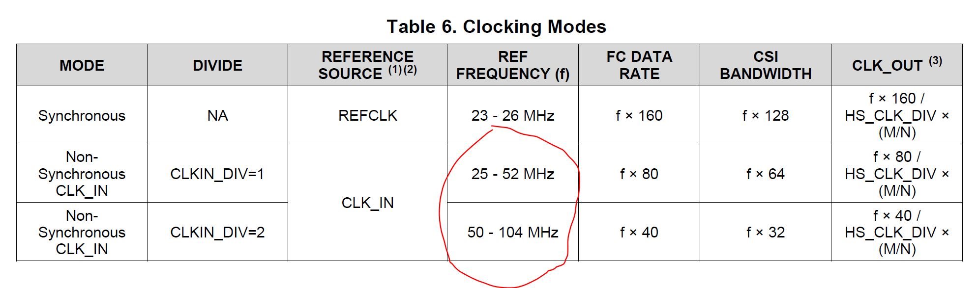

#3
They will design a datarate of 3.6 Gbps in the future.
I think that there are two setting methods in Non-synchronous external clock mode.
 No.1 : CLKIN DIV=1    FC DATA rate   f*80
 No.2 : CLKIN DIV=2    FC DATA rate   f*40
Could you tell me the difference between the two and which one should they choose?
    This would depend on your reference clock frequency and your desired forward channel rate. For example, if you want your forward channel rate to be 4Gbps, you could set your CLKIN_DIV = 1 and use a 50MHz clock, or you could set your CLKIN_DIV = 2 and use a 100MHz clock.

    I have more question for #3.
    Is there no functional difference other than CLK_DIV?
    Which one should use ref clk 50 MHz, 100 MHz for 4Gbps?
    I want to know what to consider, such as the effect on noise.
    Tomoaki Yoshida
  • Hi Yoshida-san,
    Both should work, but if you can use 50MHz , use it instead of 100MHz. Every time you have a multiplier/divider to the clock, you might be introducing some jitter to the system.
